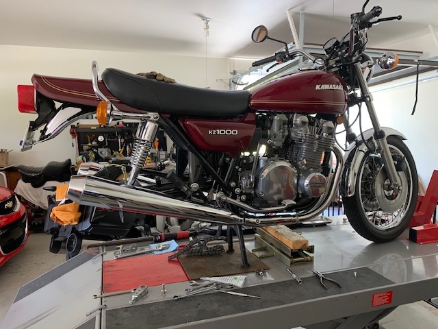

Sorry I can’t reply right now I’m out “riding” my kz.
EDIT: All kidding aside we are lucky to have Rick still with us, the reason his rear tire is off is he hit a broken off steering arm from an excavation rig... threw him and the bike into the air, damaging he’s rear rim and tire... I have only know him a few months due to this forum but can tell you he is the guy you want to pick to be on your team...

My situation that Mikaw related was an odd one even for me. 2 lane country type road, 55 MPH speed limit which is about what I was running coming up to a hill. Just prior to the hill a lawn service truck and trailer was parked on the opposite side of the road so I moved to the right wheel track of my lane to get space away from the truck. Just as I crest the hill I see something big laying in the road. No time to do much of anything but get some weight on the foot pegs and hit the object and no room on my side to try and get around it as the object almost completely covered my lane. Obviously not a good time to try and brake either, because just as I hit the object I recognize it as a stabilizer arm off a small excavator of some sort and it looks about 4 inches or more high. So the impact with the front wheel launches my KZ into the air perhaps a foot or more and rotates the bike to the left a bit. Had traffic coming at me in opposite lane and behind me and knew I didn't want to go down. As it turned out the rotation of the bike in the air took me to the left a bit away from the ditch line and I made it through the event and rode to a safe spot to check the bike and my underwear. I didn't see any immediate damage on the bike, but something just didn't feel right on it, so shelved the idea of completing my nice day ride and rode home. Put the bike on my lift and on the center stand. Rotated the rear wheel and sure enough there was a spot or indentation on the rear tire that looked out of round and perhaps damaged the tire itself and may be the rim. So off came the wheel and tire and into a motorcycle shop to have the tire replaced and the wheel checked for true. I really hope the rim is okay, but I am funny about damaged tires on a bike and will have it replaced. All in all I was lucky as this situation could have been much worse as it isn't every day you run over an excavator stabilizer arm and ride away from it. The ironic thing is up until Covid hit us I taught police officers how to ride motorcycles and have over 23 years of experience doing this. One of or sessions involves striking objects in the road. Usually when this kind of stuff happens you have a couple of seconds to set yourself up for the impact, but not this time for me. Impact was almost immediate. I certainly had a guardian angel on this trip.
