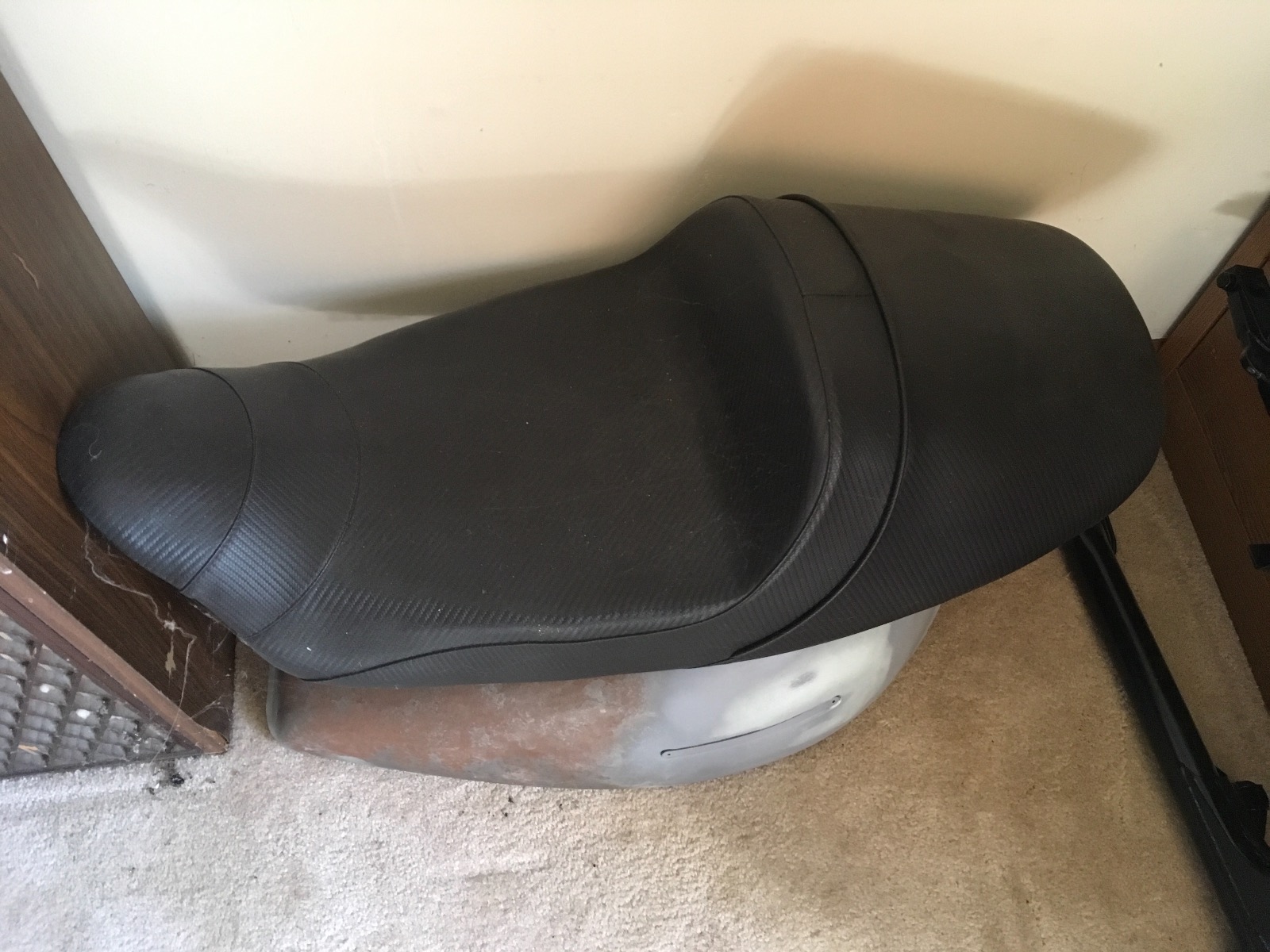

24 Jun 2020 05:55hardrockminer wrote: That's one of the ugliest seats I've ever seen! Maybe the bike is embarrassed to start. Try taking the seat off and I'm sure everything will be good.
I half expected this. I had seen your comment on a seat in the past. I know it’s made tongue in cheek and no offense taken. I have to say my butt likes it more than you do. Would this one be better.

24 Jun 2020 06:07Warren3200gt wrote::laugh: kick a man when he's down hardrockminer.hardrockminer wrote: That's one of the ugliest seats I've ever seen! Maybe the bike is embarrassed to start. Try taking the seat off and I'm sure everything will be good.
