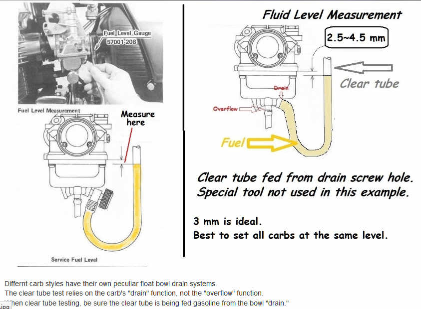

Ok yall so I just got a petcock rebuild kit in today put it in and its still leaking from the overflow lines. Like I said before all this is new and carbs are kinda voodoo to me. I took all the bowls off none of the floats were stuck everything looked in ok shape. Another member mentioned to check the fuel level inside the carbs with the clear tube test. My question on that is. Is it normal to have to set this every so often. And what is the process to do this. Everything I've seen kinda glazes over it and doesn't really go into detail about how exactly to set the fuel levels. Thanks for any help

Fuzz0912: I am not familiar with your specific bike, but the clear tube method is taking a clear tube (duh) and screwing it into the float bowl drain screw. Add gas to that carb and by holding the clear flexible tube next to the float bowl you will see where the fuel level is in the bowl. If you have a service manual this process should be detailed in it. Not as easy as it may sound especially when you have to keep taking the bowl off to readjust the level, but it's the only game in town for this unless you have a clear float bowl laying around. Others with your type of bike may chime in. Oh, and be careful with the gasoline when doing this.
