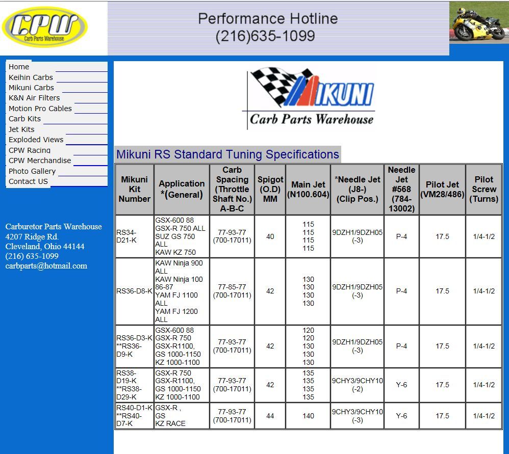

I can offer you a basic setting diagram to start with.

Cool! So is this settings that I should have to get started? I'll pull jets and stuff and compare to this.

So I got out my handheld AFR meter and welded a bung into the 4:1 collector that is on the bike. At idle it was off the chart lean. Like greater than 25:1. I'm surprised it started. I got on the pilot screw and reset them all to the same place. For reference these are the RS36-D3-K's. So starting to back out he pilot screws, it didn't get down into good range until the screws were 3 full turns out. That seems like a lot especially since the documentation seems to suggest it should only be about 1/2 turn. Do I need to be adjusting the pilot screw and the pilot air jet? Is it this just how it is?
Getting the pilot screws down into a good AFR fixed all the reving problems for sure. But now my upper RPM's are super lean. We'll fix that next.

I don't know much about those carbs but in general I think it's a sign of too large a pilot jet when they have to be screwed out much farther than normal.

Changed carbs from factory BS34's to a set of RS36's based on the Mikuni sizing chart. But according to fellow member recommendations, the 36's were "too big" for my engine, so I swapped them out for RS34's when prices were right on ebay.

Yeah so if the jet that comes stock is a 17.5, which direction do I need to go? To a 15 right?
