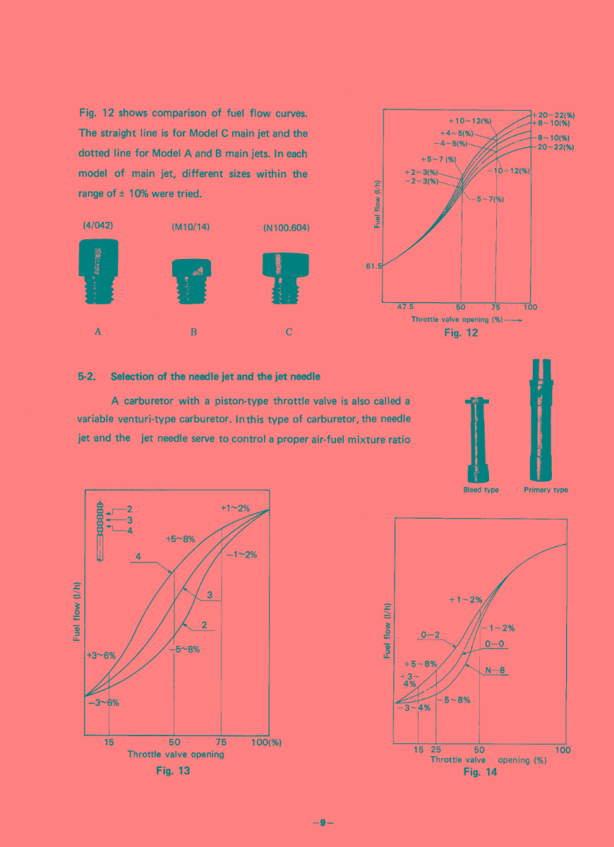

Not sure if this will help or not but here is a page from a mikuni carb manual that shows the change in fuel flow between the slots.

Very helpful information guy's. I think my jetting is close, if not dead on for the present cool weather conditions.
Amazing how one minuscule jetting change can detrimentally alter things.
