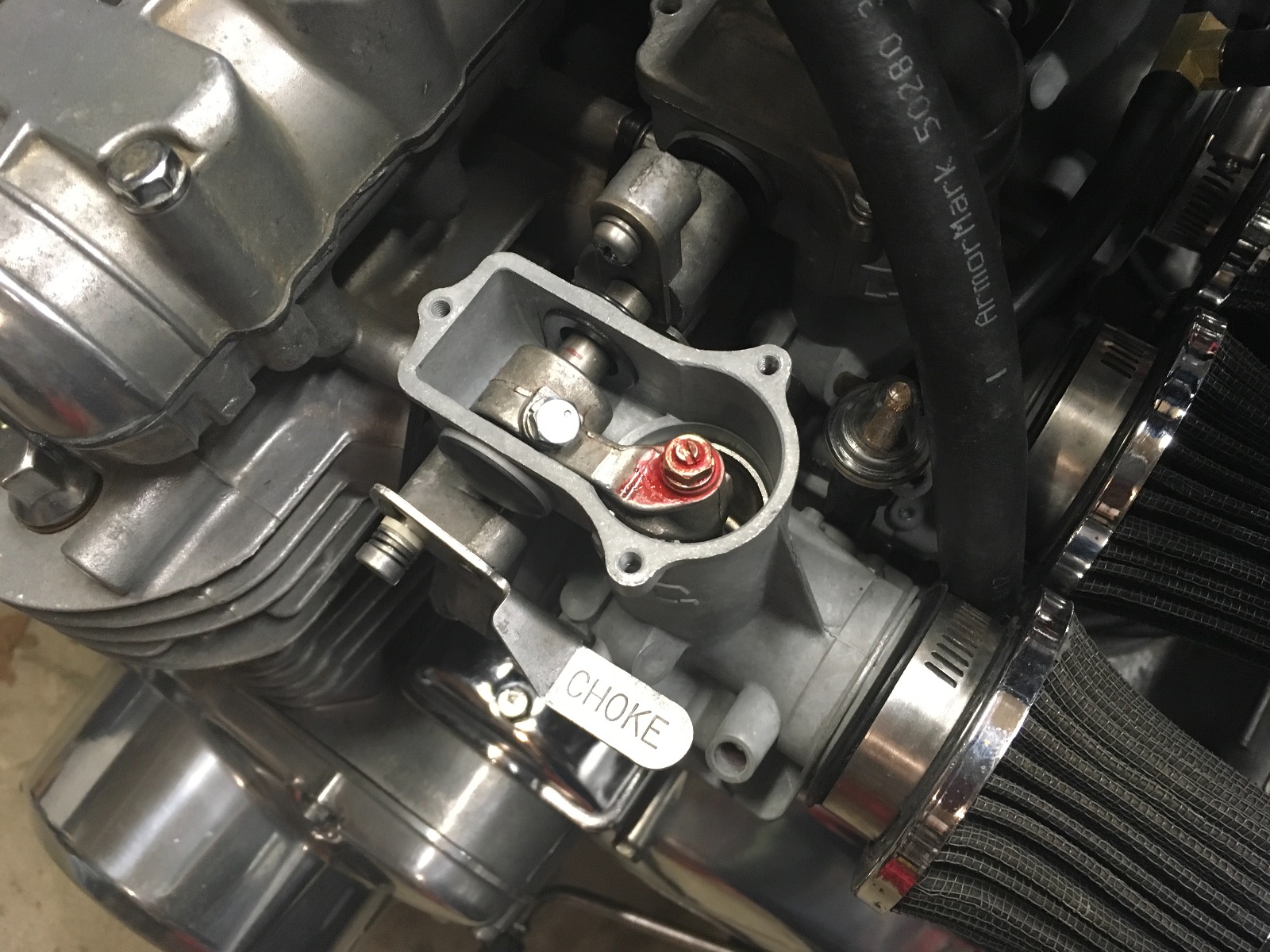

First question, the pumpers are done, installed and started for the first time. I am impressed with how well they idle just from a bench sync. Still going to put them through a carbpro sync. Unknown how but there is an unusual amount of locking paint on the synchronizer adjusters, see photo. Do I need to be concerned of paint flakes falling into the carburetor while performing the sync? I did have paint flaking off during the bench sync.

That red paint does not look stock. I've seen yellow, just a dab on the adjusters, but not red and not such a large quantity.

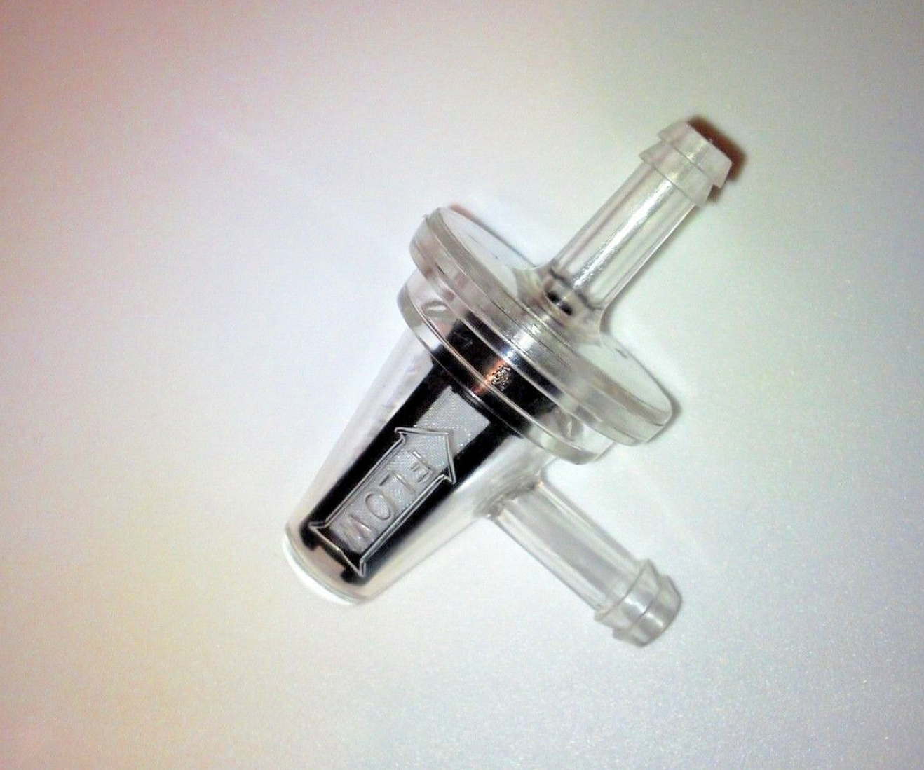

First critical path is the fuel leaks. Anyone have a connection for Corbin spring style fuel hose clamps that will fit and work on 10mm OD hose. I installed a Pingel petcock with one “goesoutta”. Used this fuel filter to make a 90 from The petcock to the tee, that’s were I’m getting the leak.

Hardrock. Thank you, I gave up for now on the odd sized fuel line and installed some that I knew I could seal and take the fuel leaks off the list. Went for a 10 mile ride around the neighborhood this afternoon. Hanging RPM is gone. Pretty impressed with the performance. I'm going to guess it was me being concerned about the fuel leaks and I wasn't letting the float bowls completely fill. Nessism was correct, it was lean. Planning on another short ride tomorrow to warn it up then going to put them thru a carb sync. How worried to I need to be with the possibility of the red locking paint flacking off and getting into the carbs while syncing?

24 Mar 2020 01:39Mikaw wrote: How worried to I need to be with the possibility of the red locking paint flacking off and getting into the carbs while syncing?
Edit: Should I tune first before sync?
The paint shouldn't be a problem or get past the slides but you could slacken off the adjusters to disturb the paint and blow the tops out with an air line before syncing.

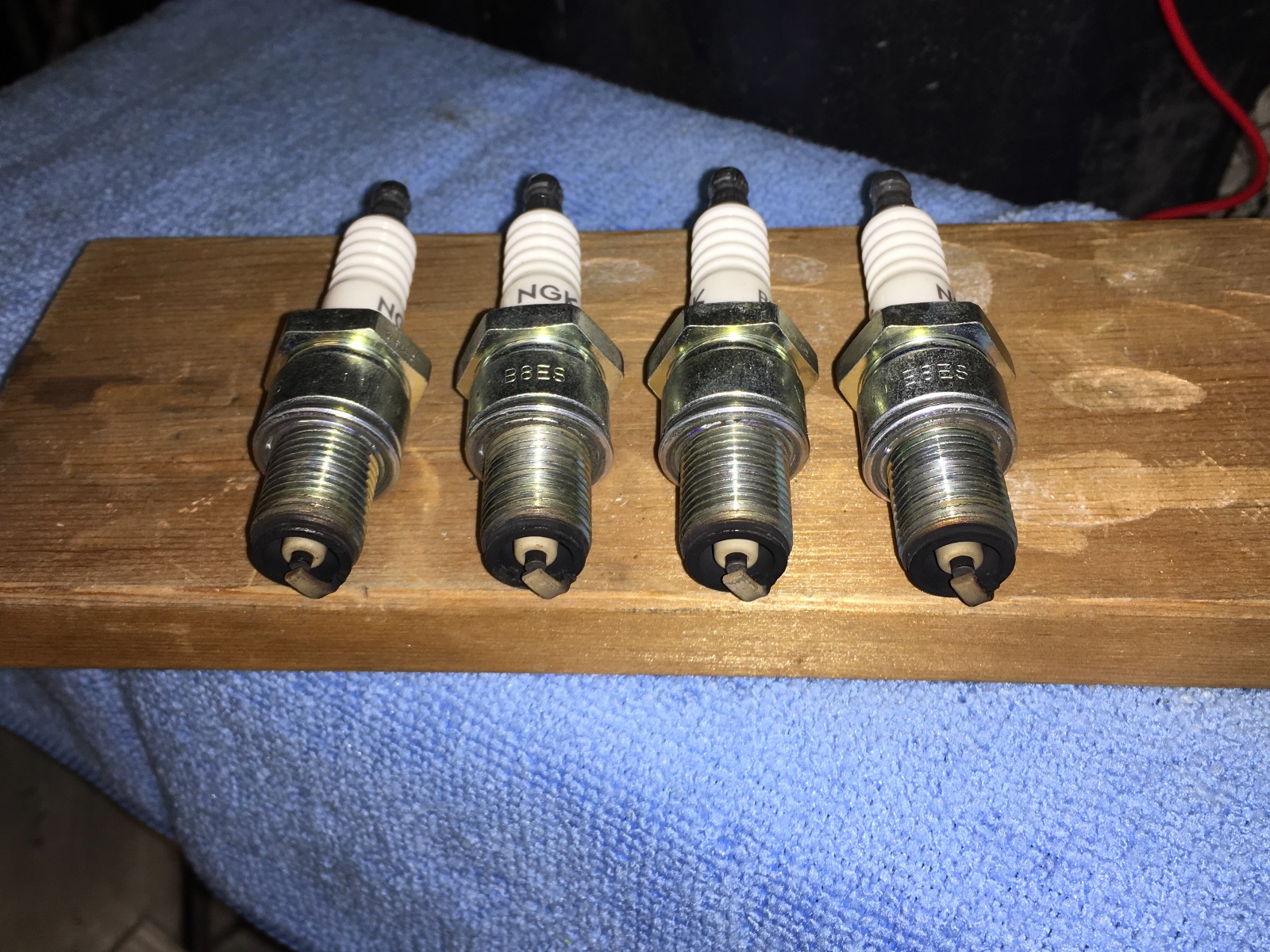

Thank you Zed1015. Only low 40's here today and with Michigan now in a stay at home order, I have nothing to do the next 3 weeks, so I will wait till tomorrow for the longer ride, MAYBE!, I only went around the neighborhood yesterday and our speed limits highest speed here is 35MPH, I cheated a few time, :whistle: :evil: I pulled the plugs last night after my short ride and plugs were black and sooty. Not worried yet because I was looking for improvement in the low just off idle performance over the previous carb rack. Like I mentioned previously that RPM range performance is way better than my previous rack. The random backfire out thru the pod filter is gone. Nice clean warm up on choke also, before it would fart, sputter and just didn't sound healthy. With that said I know I lugged the engine and more than likely caused the rich condition. I will get it out sooner than later and up in the RPM range to get it to clean up the plugs and cylinders. I'll make a few hard runs and check the plugs and if they have cleaned up I'll do a sync and start the tune process. Thank you for the guidance.

The sooty base ring is jetting and earth strap is heat range.
They look pretty good for a Z and don't really get much better.
Better to be slightly on the rich side anyway .
The base ring only indicates the jetting at the speed you cut the engine so that is at idle I presume and you need to do plug chops at higher speeds to see how close the jetting is there.

Thank you for the help and advice. Your correct in that was at idle. Rode home after the couple of hard pulls and it idled a few while I opened the garage door. Great resource article.

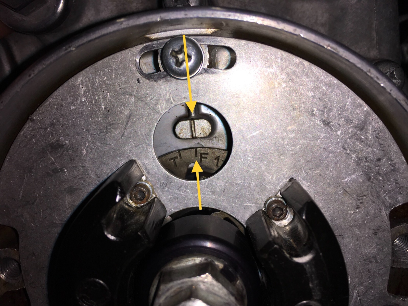

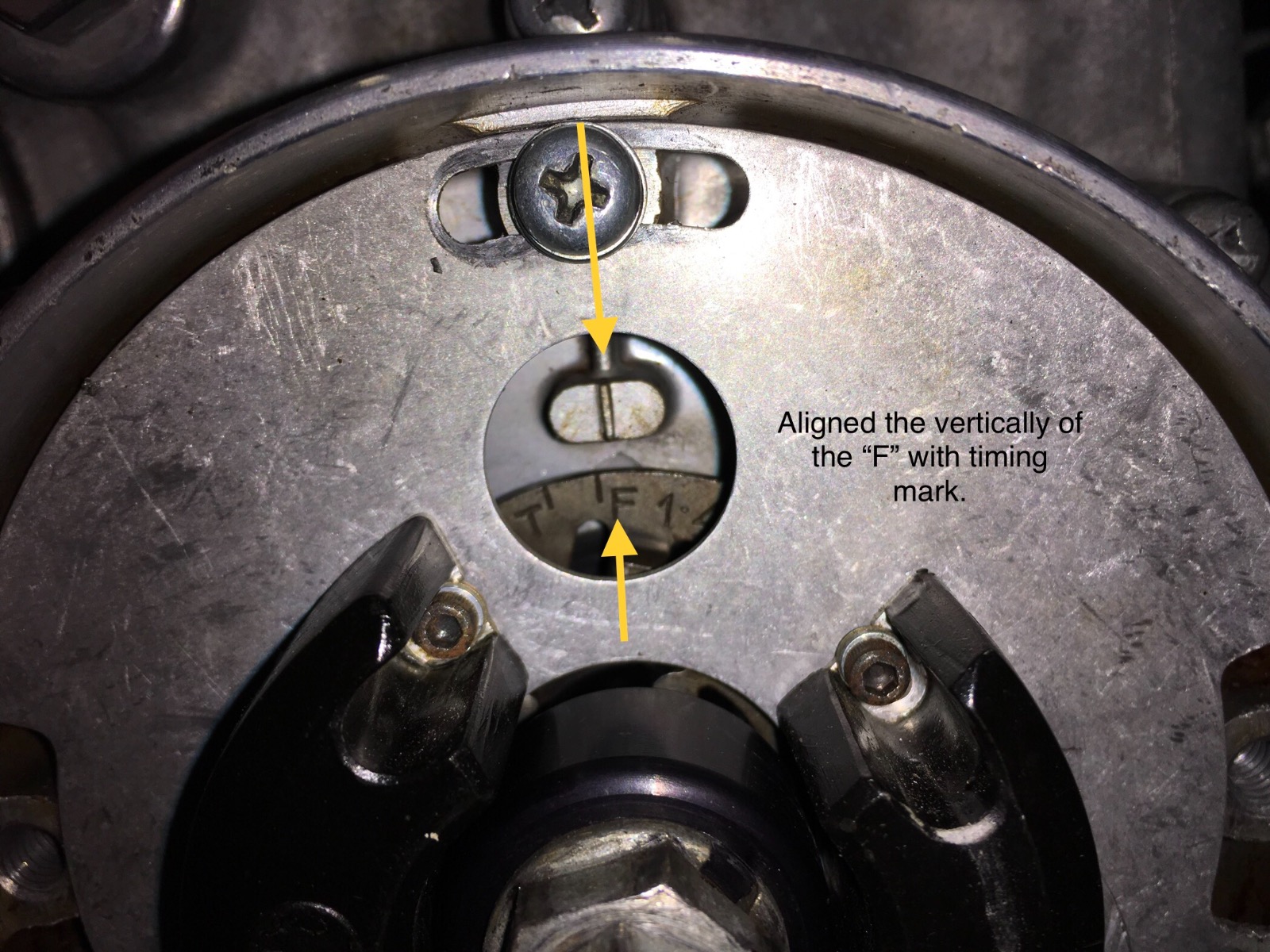

Do you have a comment on timing. Can it be advanced or is it better to leave it alone. Full disclosure I advanced it last night before the run. I have no way of telling number of degrees. My advancer plate has a line for the “F” mark.
And the letter “F” is stamped on the plate just advanced of the line. I only advanced enough to get timing directly over the stamped letter F
