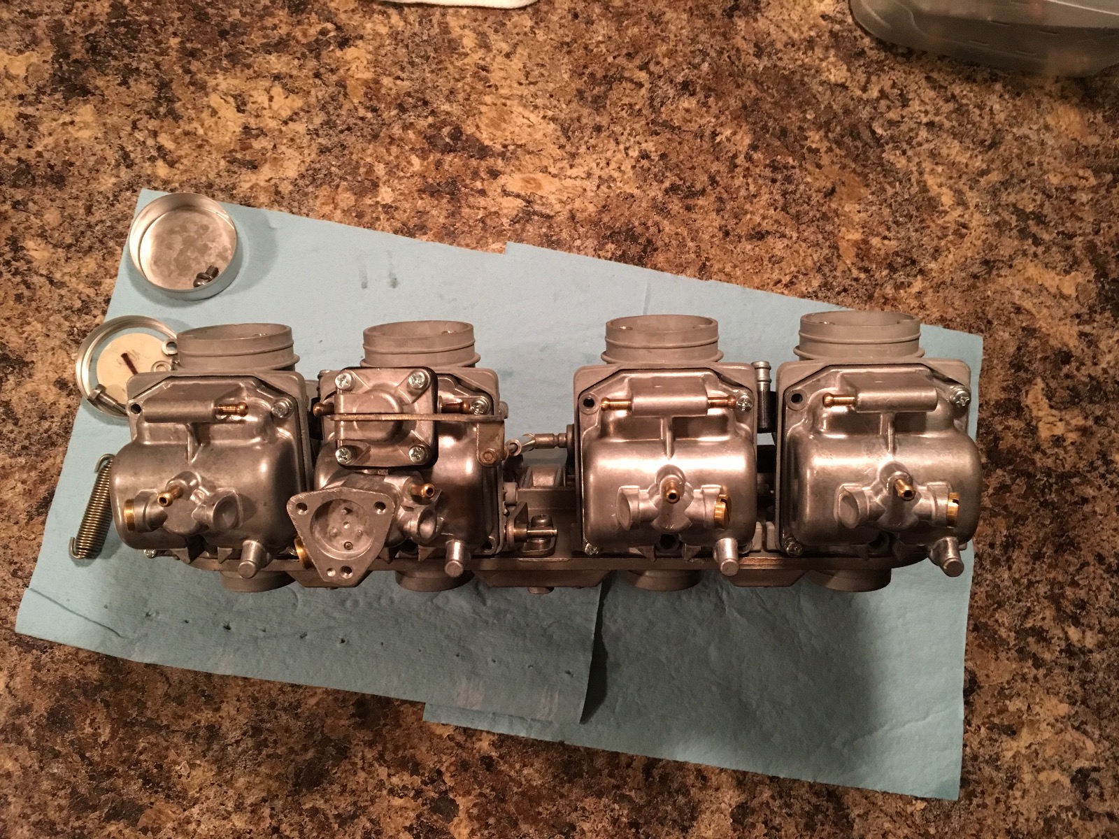

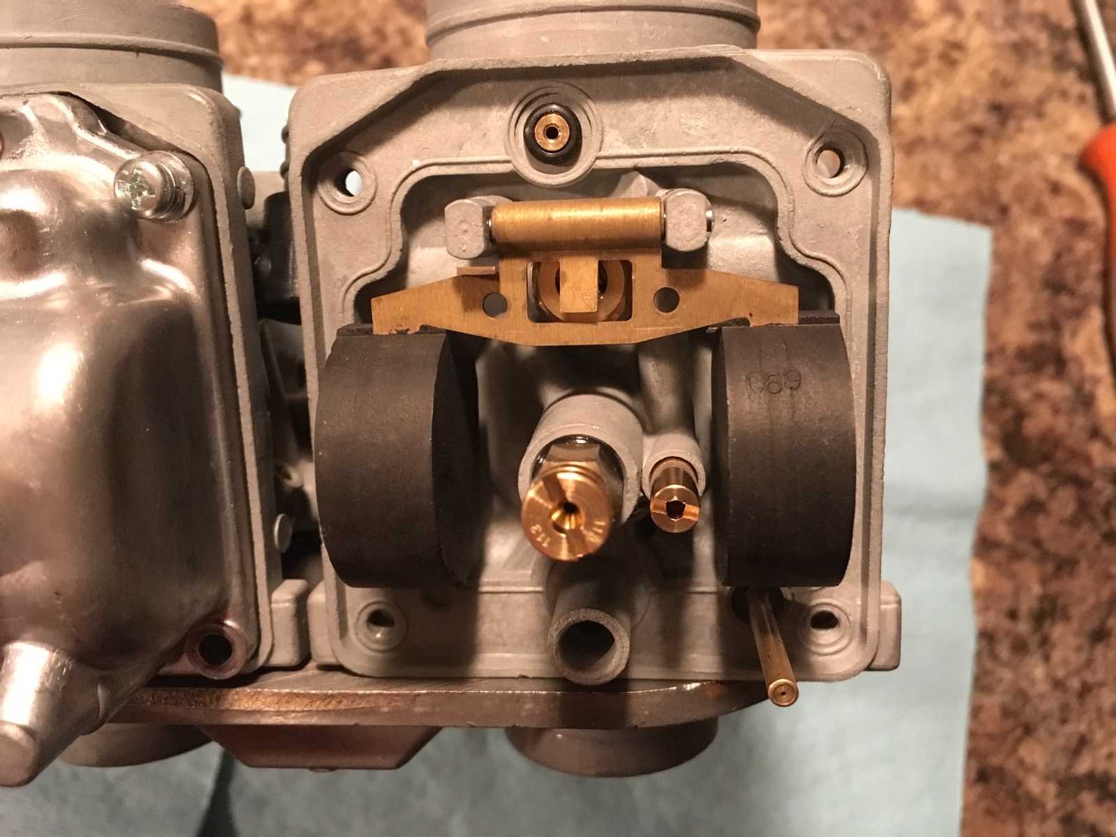

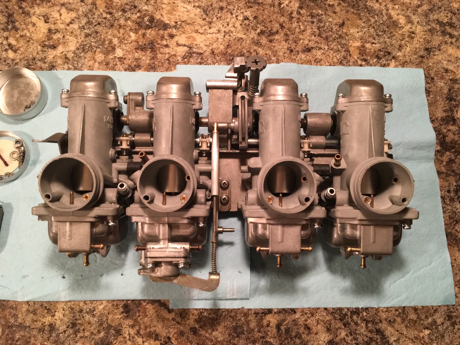

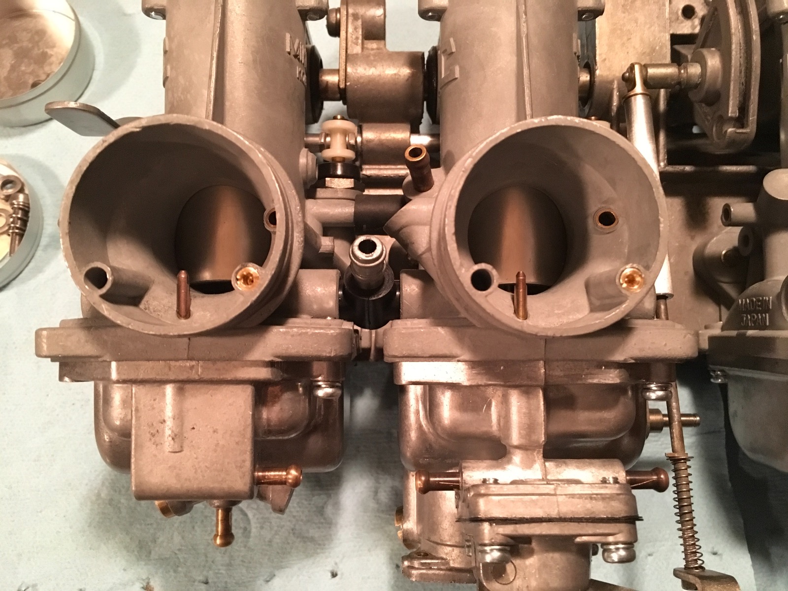

These are the correct carbs for a 1980 KZ1000 B4
I bought them used and installing them on my 1978 KZ1000 B1
I’m just finishing up a rebuild on them with the help of members here specifically Zed1015.
I bought Keyster kits but only because the used carbs didnt have any main or pilot jets. It was the cheapest way for me to go. I was pleases to find out the Keyster kits have a rubber bowl gasket that seam very robust and should be a big asset when tuning. . I’m learning also that others here are correct to not buy “kits” to many variables and wrong parts.
The following user(s) said Thank You: Rich K.

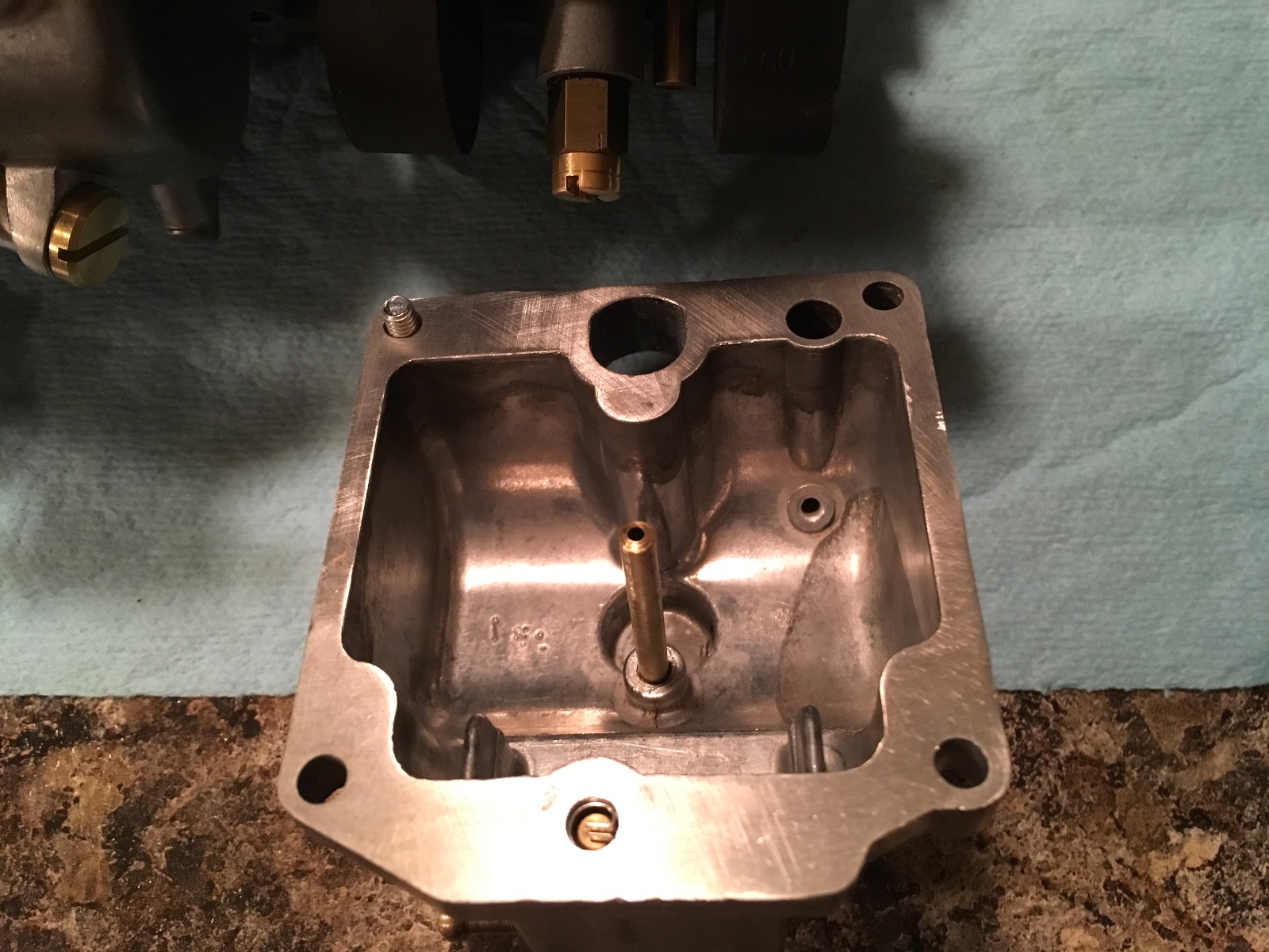

One of the most overlooked points on carbs is the needle jet. It sits just above the emulsion tube in the main jet cavity. Over time it will wear on the downstream side from rubbing of the needle, so it should be replaced periodically to maintain proper fuel flow. Needle jets are included in the Keyster kits but not in any other kits I've seen.

I've never seen a worn needle jet in the 100's of VM carbs I've rebuilt over the last 40 years. in fact I've only replaced one needle jet and that was because someone had used a steel punch to drive it out, doing so mushroomed the jet. I'm sure there is wear but not enough that you'd notice performance wise.
I have a set of VM24 with well over 150,000 miles on them. There is no noticeable wear in the needle jets. No where in the Kawasaki manual does it indicate to replace the needle jet as routine maintenance.

I removed the Needle jet and inspected them and found no wear. These were a used set with unknown millage. but showed now signs of wear on either the needles or jets, I pulled one slide apart to verify they were the factory 5CN29 needles. I reinstalled them. I understand the theory of the air velocity pressing the needle against the jet and causing wear. I have only rebuilt 3 sets so far but I have had to replace one needle and jet on a set of VM 26's Its possible they wear but not the norm. I'm by far and expect but I have encountered the problem.
