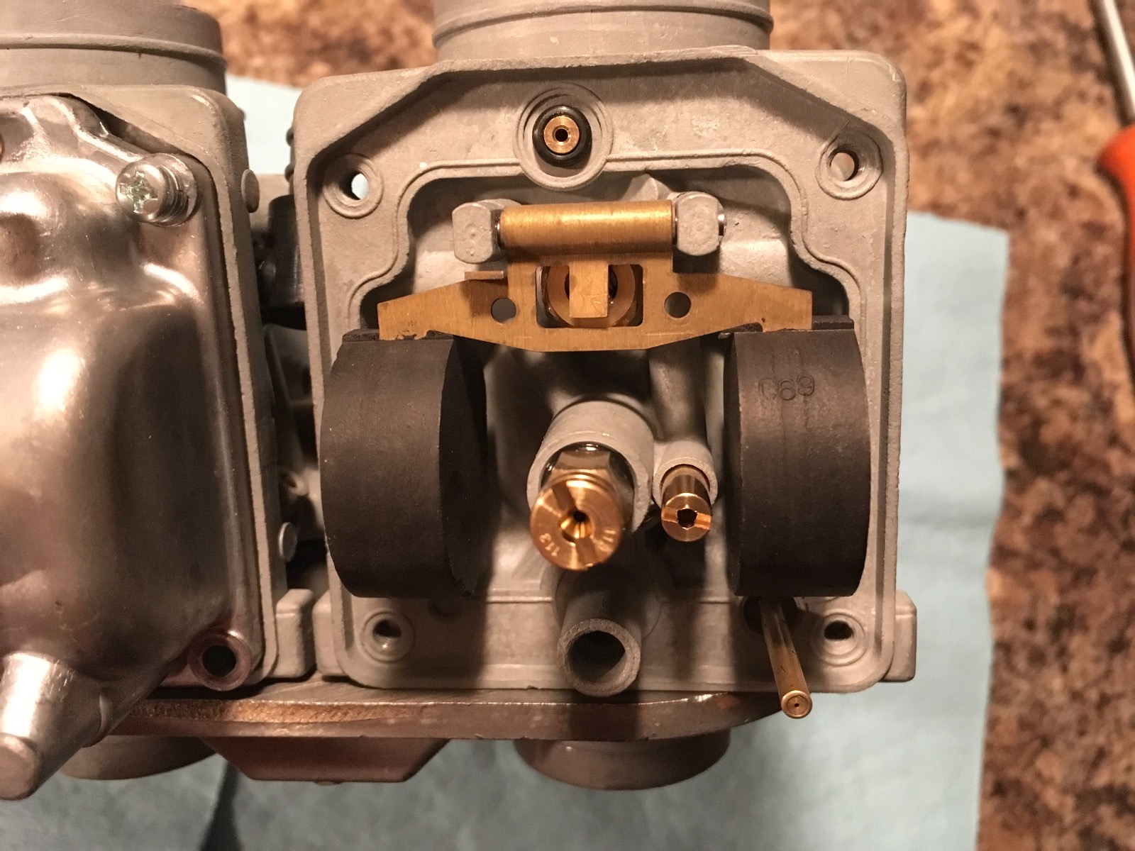

I don't want to come off as a salesman for a foreign company but I just received Keyster kits today from the Japanese company that were ordered on March 5th, One week to receive kits that average $40 per kits and about $28 in shipping. I will purchase from them again.

12 Mar 2020 19:04Mikaw wrote: I don't want to come off as a salesman for a foreign company but I just received Keyster kits today from the Japanese company that were ordered on March 5th, One week to receive kits that average $40 per kits and about $28 in shipping. I will purchase from them again.
That's a lot of money. Unless the factory jets are damaged I don't typically replace them when rebuilding carbs. Also, "carb kits" typically don't include the interconnect tube O-rings so you still need to chase those down regardless.

That's a lot of money. Unless the factory jets are damaged I don't typically replace them when rebuilding carbs. Also, "carb kits" typically don't include the interconnect tube O-rings so you still need to chase those down regardless.[/quote]
I would agree normally, but the used carb rack I purchased didn't have any main jet and only one pilot jet, So factoring the cost for those missing items and Not having any additional jets to aid in tuning I weighed my options and keyster was the biggest bang for my buck. On top of that I received new float needle and seats and extremely nice rubber float bowl gaskets. If your revering to these O-Rings you are correct they didn't come in the kit. and they were sourced from an additional company.

I've bought a few Keyster kits for Z1 carbs. They are the only kits I've found that include a needle jet. Unfortunately they include a lot of stuff that I would never use...three pilots, six main jets, four needles... They are made for an enthusiast who likes to change things up. That's not me. I rebuild them back to stock and don't need all the extra stuff. But I've seen the improvement when the needle jets are changed so I'll continue to buy Keyster kits. Oh..I really like their gaskets too.

Another issue with any carb kit is they do not include mikuni jets so the jets sizes are a mystery. The number stamped on the jet most likely is not going to be the same size as a mikuni jet. Same with the needle jet i would rather use a used mikuni needle jet over a new unknown sized one. You can buy new mikuni jets and gaskets cheaper than the aftermarket carb kits.
Everytime someone sends me a set of carbs to rebuild the first thing I do is to verify the jets. If they are not mikuni I toss them in the trash and put in the correct ones. You'd be amazed at the mixed match jets I've seen. The customer will tell me they can't get the carbs dialed in. When I check the jets they have aftermarket mixed with mikuni ot other aftermarket jets.
