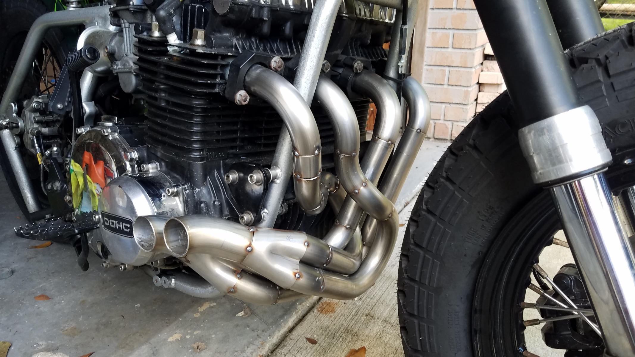

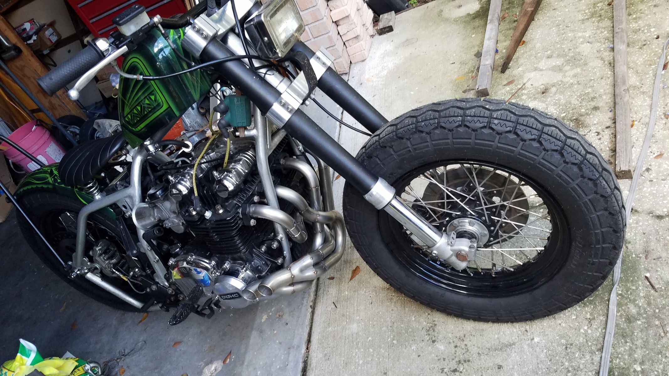

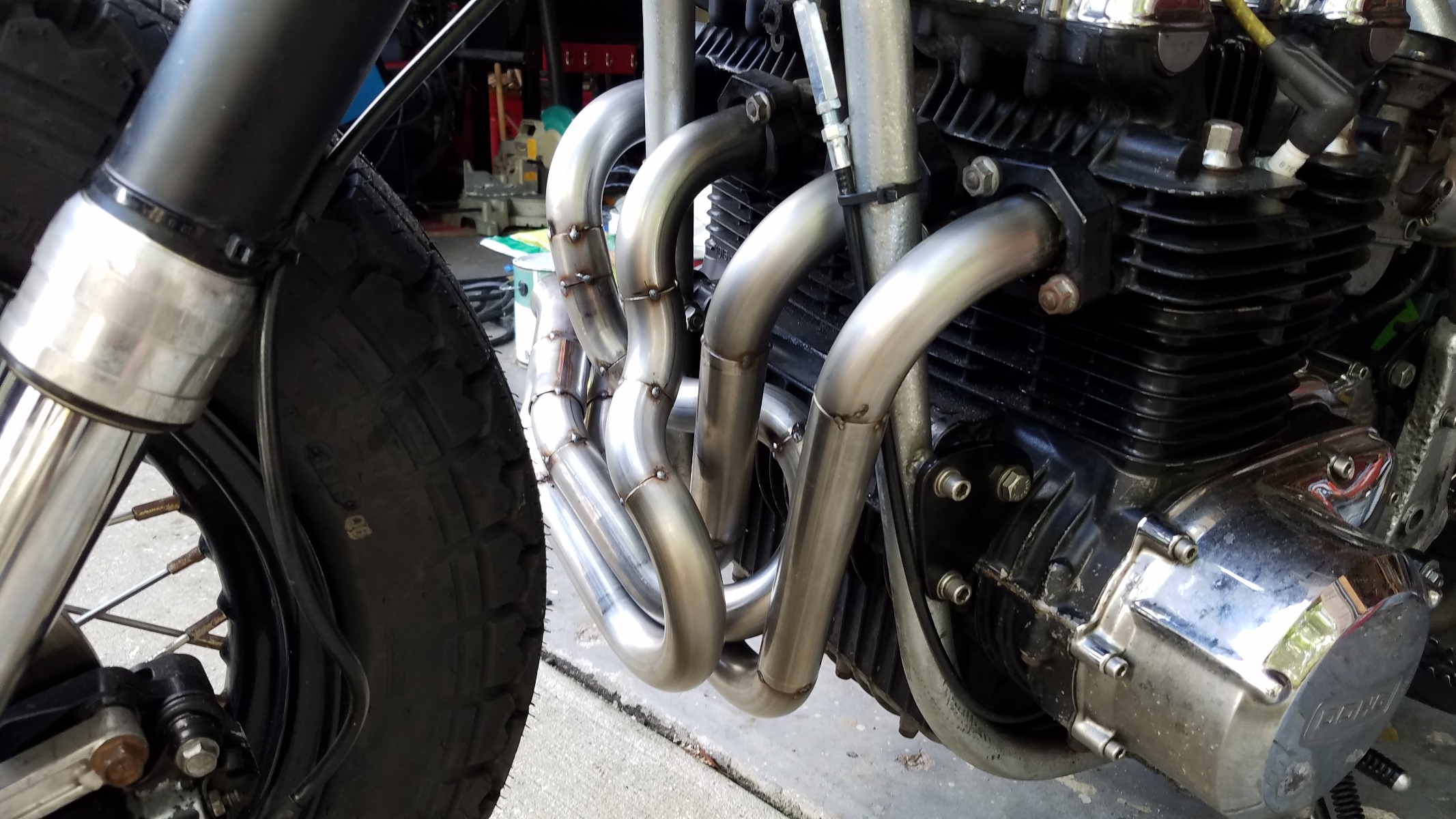

I fixed your pictures to enlarge them, Next time hit the insert all tab to complete picture posting
If not racing , and wanting more responsiveness I would find a set of stock 26mm or some 28mm carbs and just jet them to run correctly.
Small 26 mm carbs would be snappy as air flow is higher at lower rpms
Pipe looks good for chosen design but will be real loud . Tuning may be tricky too

Thank you dave! Everyone has been awesome on this forum for my first post. Yes they are very loud! They get a nice dissonance running cylinder 1 and 2 then 3 and 4 together. Sounds like a v- twin and an old kaw inline hybrid unbaffled. Very pleased with the result. Sorry there's no pics of it tigged together. I'm gonna run a high polish on the pipes as they are stainless.

Whoa, whoa, whoa, were gonna need more pics of that chopper. did you fabricate that header? looks crazy!
