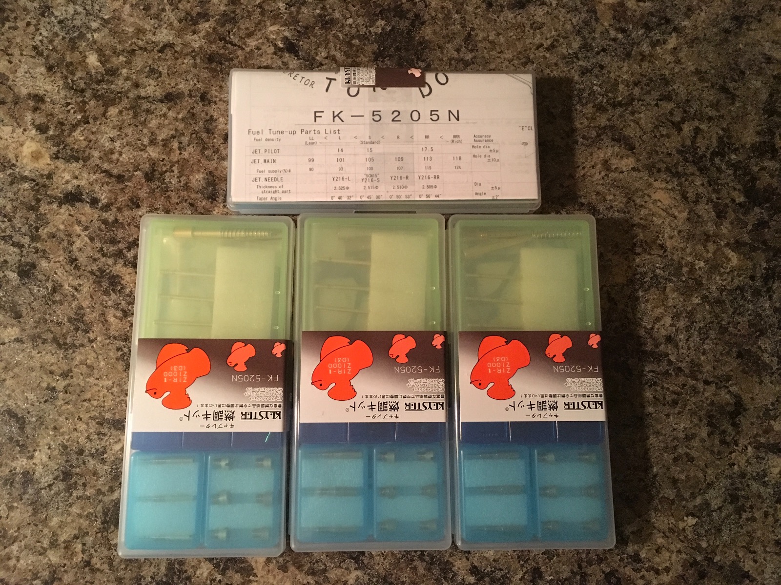

12 Feb 2020 20:26
Christmas in February. All went super smooth. Great packaging, looking forward to getting them installed
