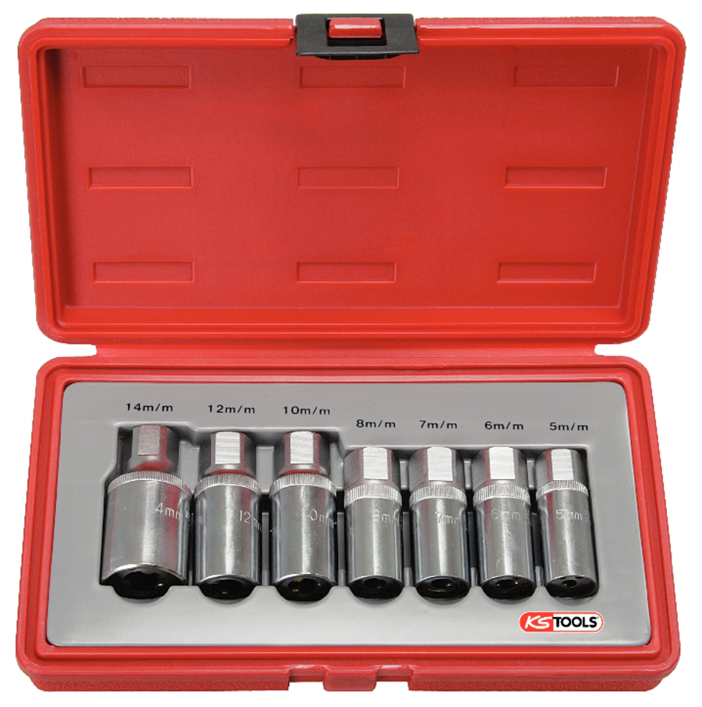

Think I need some advice,
I was going to attempt the two but trick to pull the stud out. I can get two nuts on it but there aren't enough threads to hold.
any tips on getting it out? makes it even harder when the OEM stud is painted on to the case. was thinking about maybe using jb weld to get the nuts to stick.

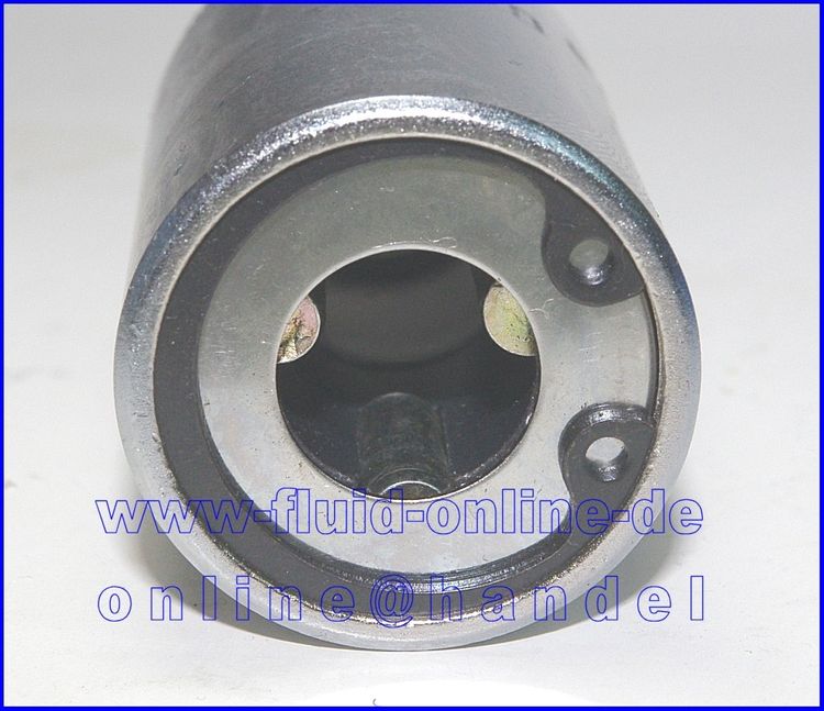

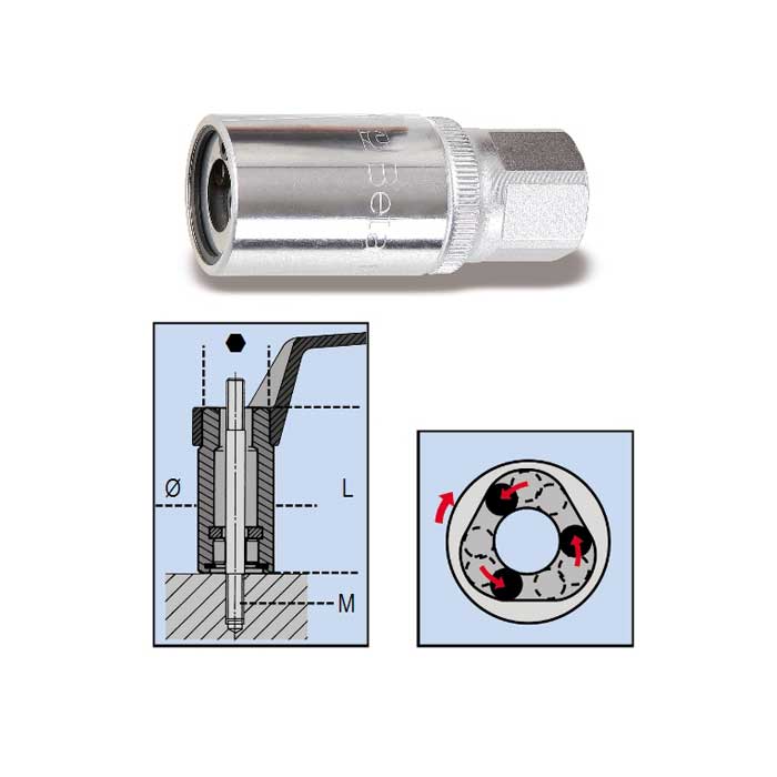

13 Dec 2019 13:26Caleator wrote: Think I need some advice,
The studs on the frame have a nut on the inside. On the head I suspect they used a locking agent on them. I pulled mine with the help of a little heat.

striped the screws out of a pair of locking pliers but ended up getting it out. sooo much time torquing, 1/8 turn, un-torque, repeat (lots of pb blaster lol).
Put the exhaust on with a bit of a struggle only having two arms. I definitely like the copper gaskets better than the ones that came with the pipe.

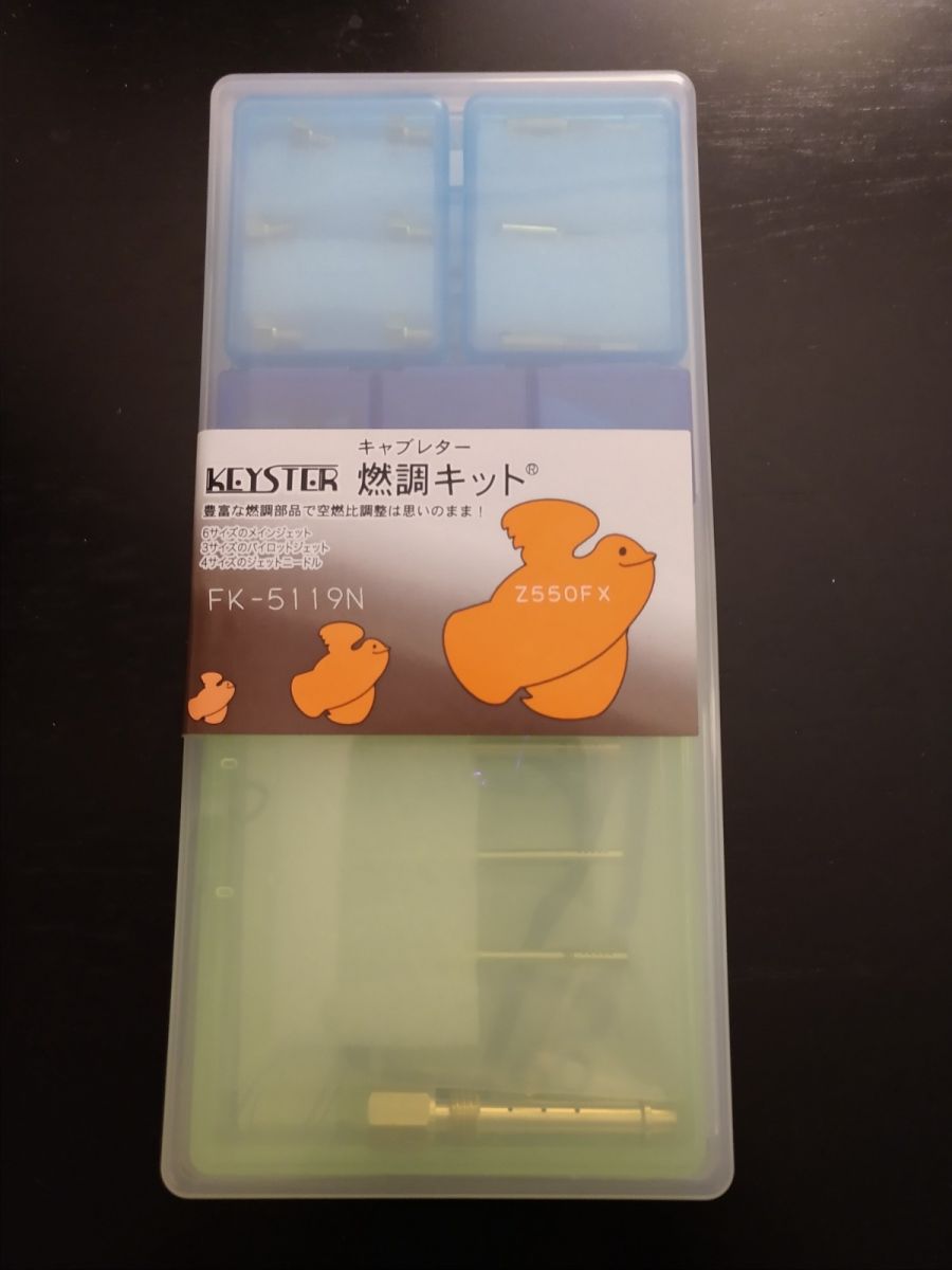

So recently received some keyster kits and they look great. The main jets that come with it have the same flow as the TK stock mains.
Currently my air screws are nearly turned in all the way, so I was thinking about putting the 95 jets in them (94 are in currently)
My question is: roughly how many air screws turns is one jet size worth? The next size up from the 95 is a 99, which seems like too high of a jump for how decently its running right now.

The keyster main jets are usually #92. The stock mains for the 550D1 is #94. They do flow pretty similar, but definitely not the same.
Main jets and air screws have very little to do with each other. Air screw setting may be affected by pilot jets, but the correlation is likely different under different circumstances. The TK22 website shows the very approximate throttle ranges affected by each of the jetting variables.
Are you still running the airbox and Yoshimura exhaust? Also, are you using the factory needles or the kit needles, and what position is it? There are too many variables to give an exact formula, and there is more than one solution to getting a well-jetted bike. It also depends on what you are looking for, like fuel economy, cold-weather running, maximum power etc.
With the airbox in place, it should still be able to run without much change from stock jetting, but may need choke a bit longer.
How do you know the airscrews are set where they should be... in other words what procedure did you follow to set them. If you set them while cold, then they probably need to come out a bit.

The keyster kits I have aren't really the rebuild kits, but a keyster tune-up kit. comes with 6 main jets, 3 pilot jets, and 4 needles, all varying sizes (also gaskets o rings and everything else to rebuild)
Currently I'm on the Yoshi 4 into 1 pipe and stock air box which I'd like to keep.
The carbs I'm assuming are stock, I haven't opened them up since buying it end of last summer. past two previous owners just kept it clean in their collections.
So what I was thinking to do was to put it the #95 main jets and maybe a richer pilot jet? next pilot jet size is #38.
