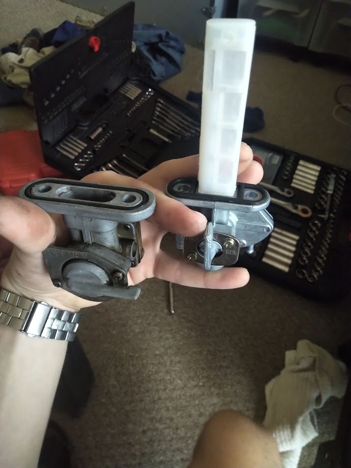

My petcock recently failed, So I ordered a new one off amazon trusting their compatibility thing since it wasn't very expensive. I ended up with a petcock with mounting holes too small.
I ordered www.amazon.com/gp/product/B07R6XFKDT/ref...02_s00?ie=UTF8&psc=1
And yeah, if I would've read the description and measured the holes, id have known it wouldn't fit, but I didn't.
According to the parts diagram, I need 51023-1023, which is no longer available. What could I get to directly replace it?
Before anyone suggests I rebuild it, its simply not possible. The little tap that the fuel comes out of has actually fallen out, so its essentially junk.

Can you post any pics of your petcock and the bolt pattern/spacing?

Holes are too small or the hole spacing is off?

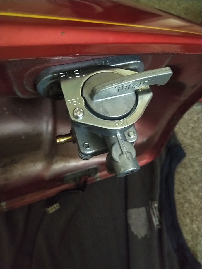

Holes were too close together.
I bought the kz1000 petcock and switched the back of it 180 degrees, it fits no problem.
Got everything running again. Thank you!
