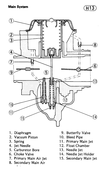

I'm confused about how/when the air passes thru the main intake. It's something I've never understood - why does the jet needle retract when there is air pressure pushing it down? The throttle controls the amount of air passing thru the carb so how can the fuel push the needle up before the air pushes the needle down?
With pod filters, you have to restrict the amount of air passing thru the main intake somehow, so I think if I restrict it or redirect the air between the pod filter and the main air intake of the carb, I should be good... but we'll see how easy that is.
That helped, but also didn't help lol!

What?
The air entering the carb is forced under the slide. As the throttle is opened, more air enters, PUSHING the slide UP. At the same time, the low pressure behind the throttle plate creates vacuum that PULLS the slide UP.
Air always goes through the main bore of the carb, but at idle there is not enough velocity to pull fuel up through the main jet. At low throttle openings, the throttle plate creates a low pressure area at the pilot openings, thus pulling fuel through them. Once the throttle is opened enough, he incoming velocity is sufficient to begin raising the slide and pulling fuel from the main jet, which is regulated by the tapered needle. When the throttle is nearly wide open, the slide will be pushed all the way up, so the needle no longer regulates the main jet. At that point, the main jet is responsible for the mixture. Yes, fuel is still coming through the pilot circuit, but it is only a fraction of the overall mixture.

So you mean that air coming makes it's way into the float bowl? That's the only way the needle could get pushed up, isn't it?

No. The air goes under the slide. Between the slide and the bottom of the carb bore. The next time you have the carbs off, take a close look and you will see that the slide does not seal against the bore.
