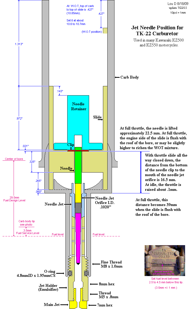

Yes, in that context, I think he means the area inside the emulsifier tube, or a part sometimes generically called the jet holder (but simply holding the jet is not the main purpose of the jet holder). That volume does equalize to bowl fuel level when the engine is shut off, and will be at a lower pressure than the bowl when running and the fuel will be at a lower level in addition to being turbulent with air mixed in.
I just generically referred to it as the "path" but I guess it is a "fuel well" for the main metering needle and needle jet.
On this graphic for the Tk22 you can see the static fuel level would be about in the middle of the emulsifier tube (aka jet holder). When running, air will bubble through there turbulently and the fuel level will reduce when the main circuit is on operation, so the fuel level inside will be much lower. There will be so much turbulence, I'm not sure you could really say where the level is exactly, but it will not be sitting at the same level as the static level.
