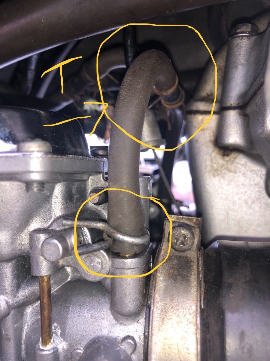

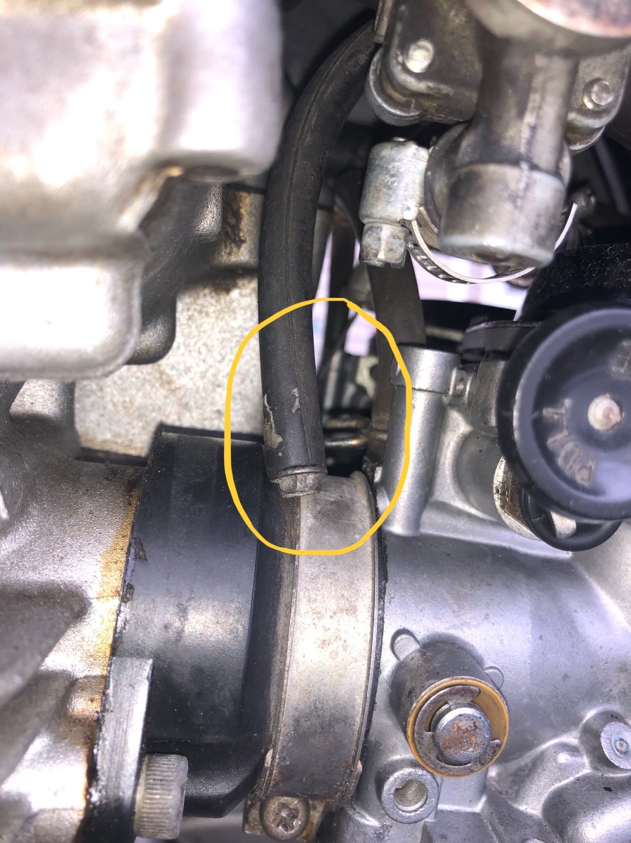

There are 2 vacuum lines that go to each carb near the manifold and then a T connector from these lines that is capped off. This vacuum line looks too small to connect to the petcock but there aren't any other vacuum lines unused.

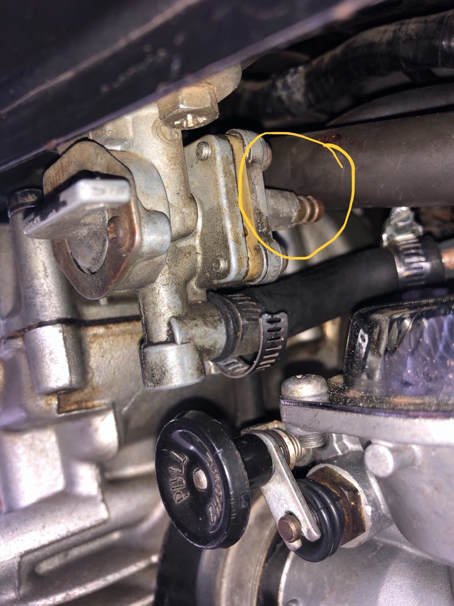

I think it would be very helpful if you could provide pictures of your carbs and of the ports on the carbs for the "vacuum lines" and any other carb ports. Ed

Edited: From the KZ750-K1 airbox diagram at partzilla. In the Kawasaki clean air system portion of the drawing there are 2 Tees >> the one nearest the airbox cap has the carb vac port tubing & the other Tee underneath the fuel tank has the petcock tubing.

I am going to put some pictures up but could someone just answer where the fuel switch position is supposed to be when parked overnight, and assuming I have a working petcock? PRI? RES? ON?

ON if the petcock is working properly. In that position fuel should only flow through the petcock when the engine is running in which case vacuum is applied from the carb to the petcock. With the engine shut off the petcock should prevent the flow of fuel. Of course if the petcock diaphragm or other components are damaged fuel may flow even with the engine shut off. Ed

23 May 2019 00:39

If there's tubing connected to each carburetor, then the tubing in the last pic is for the petcock vac port in 2nd pic. In the airbox diagram the carbs would be connected to the tubing nearest the airbox cap & the petcock vac line is connected to the other T underneath the fuel tank.
