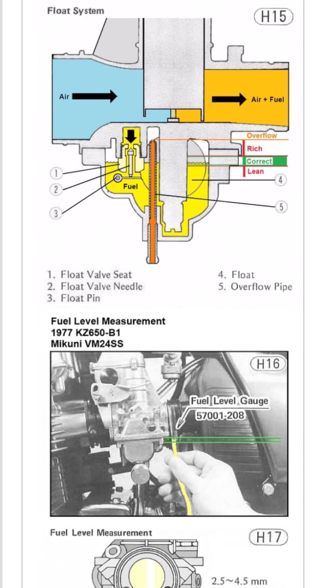

You need to set the float by the wet method. 2 to 4mm below the bowl mating surface. The height icrease or decrease from level of the tang to achieve that is irrelevant, its the fuel height that matters.
The valve needles from diffeŕent manufacturers would need the tang position different due slight differences in needle length and internal spring strength.

When adjusting float tangs, the tiniest of increments produce relatively large changes in fuel height.
Dry float setting usually get floats in the ballpark. Wet adjustment is the most precise.
Some manuals specify fuel level as the distance between the carb throat's bore center and the top of the fuel pool in the float bowl.
Be prepared with generous amounts of patience & don't try to rush it.

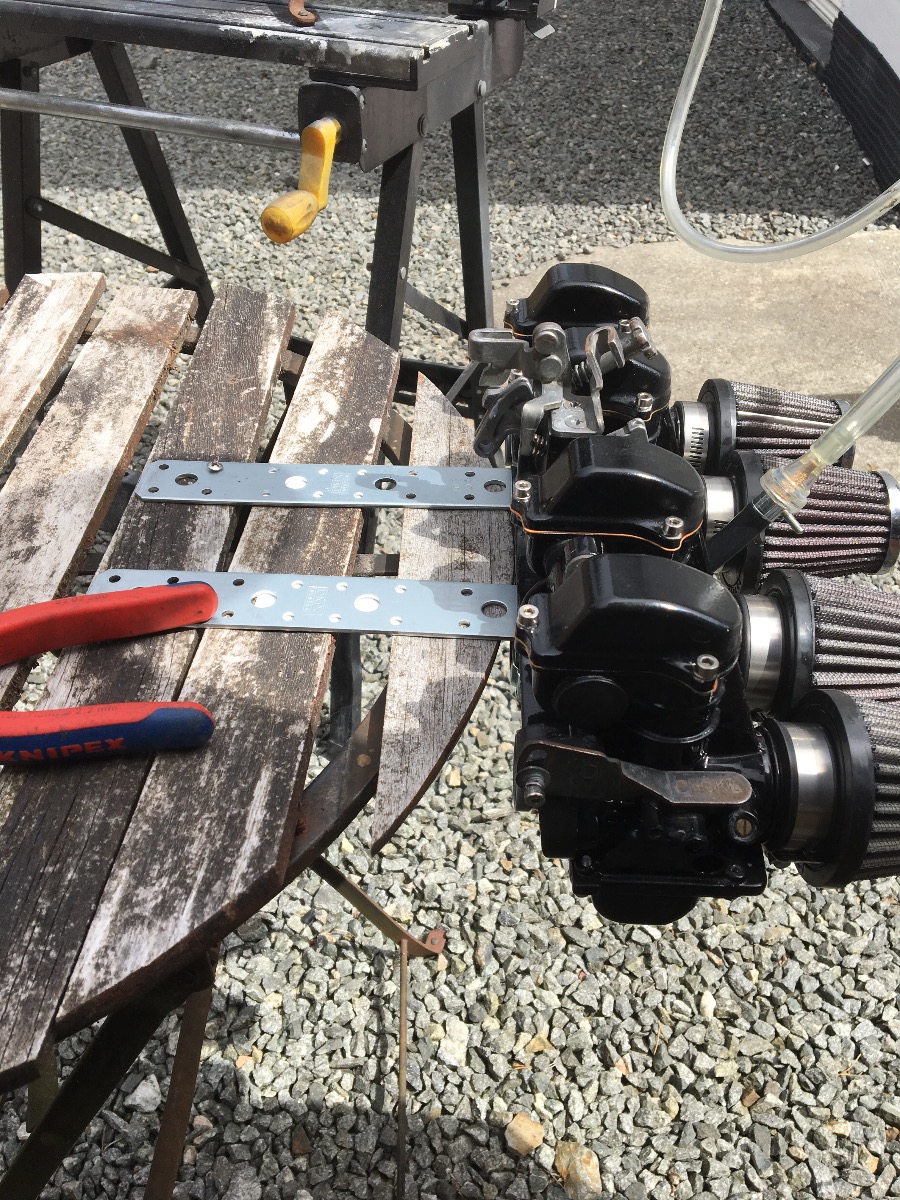

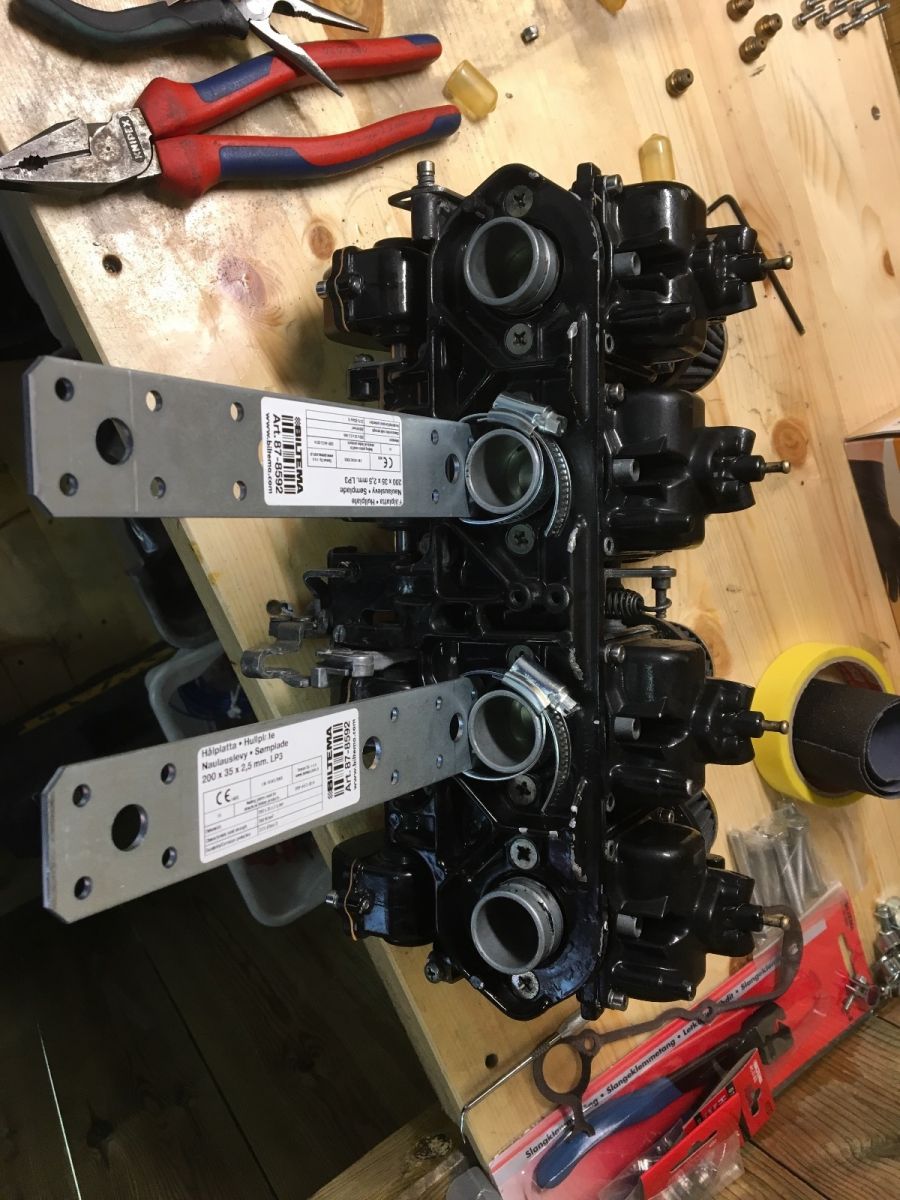

I made some bracket so I could adjust and measure many times without installing the carbs each time.
Project:
Project:
Last edit: 16 Apr 2019 14:03 by gordone.
The following user(s) said Thank You: Nessism, scubaanders
- scubaanders
- Posts: 555
- Thanks: 238
Re: Float height for dummies
16 Apr 2019 21:44
Thats the Wway to do it.
In carb boots, carefully in a vise or why not in two pieces of hole plates.
Good work Gordone
/A
Good work Gordone

17 Apr 2019 05:47 - 17 Apr 2019 05:55
By slmjim+Z1BEBE: When adjusting float tangs, the tiniest of increments produce relatively large changes in fuel height.
+1. . I didn't want to mangle the floats, so instead of bending them, I flexed each tang x number of times. Flex, flex, flex with an appropriate tool, reinstall & check the fuel level. Then do it again. I spent a couple of hours & got all four to exactly 3.0mm below the carburetor body. To speed up the process you don't have to use all 4 float bowl screws per carb each time >> I used 2 per carb, some guys only use 1 screw per float bowl. Also, I rigged up a simple float support so the tangs were easy to flex, and like gordone I also made a carb stand >> 2x4s w 2x6 base & a couple of angle iron L-brackets plus a bungee cord.
