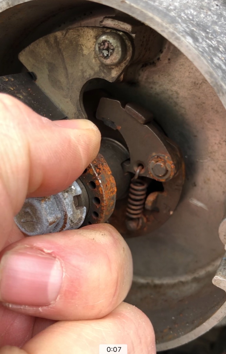

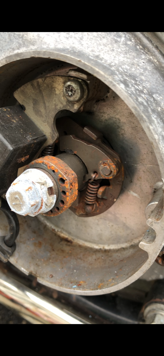

08 Apr 2019 08:00DoctoRot wrote: It could be a timing issue. Check your advancer to see if it’s rusty
This? I cleaned this up and it moves freely. Now I am getting popping while idling.

hard to say from the video. If you cleaned the advancer and it got worse I'd verify the timing is good. You shouldn't have to mess with and electronic ignition once its set, so the state of the Philips screw on the ignition plate is a bit alarming. check it with a timing light and make sure its advancing correctly.

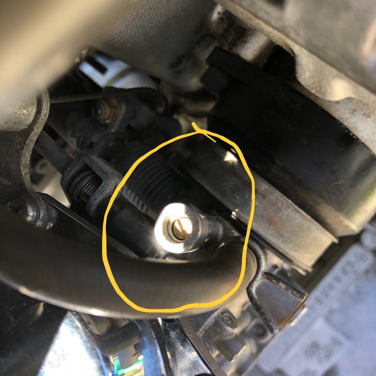

That popping at idle doesn't sound like a timing issue, as previously mentioned the timing is not adjustable (although it looks like someone thought it was or removed the pickups for some reason). In my experience that popping is caused by a lean mixture. Are your mixture screws accessible? Any work done on carbs? Not having the stock filterbox etc. will cause some issues with stock jetting.

I think timing was part of the issue. It would pop out of the carb on throttle. After I cleaned it up it does not pop on throttle. Also, there is no leaks at the manifold now.
I don’t think there is any carb work done. I’m going to pull the carbs off again today. What should I do if the mixture screws are accessible?

Stuck or sticking advancer will definitely cause popping and hesitation off idle as you've described. Glad you got that sorted.
If the carbs were ever properly cleaned, the "plugs" on top of the screws will most likely be removed allowing you access to tune the pilot mixture. If the popping is caused by a lean condition, you can richen the mixture to address it. There are multiple ways to do this, I use a colortune but you can also search up "idle drop procedure" to set this. Fuel levels are important too, only takes a few minutes to check them.

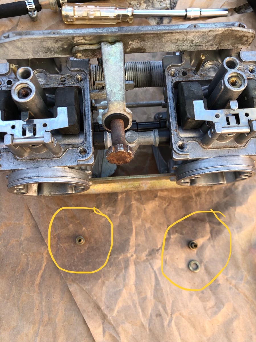

Stop the freaking presses. I pulled the carbs off to thoroughly clean them and I found a missing washer! I guess this could be contributing to the problem.
1983 Kawasaki KZ750 KZ1 LTD (belt)
1980 Honda CM400T
1980 Honda CM400T

I'm not sure if that washer missing will cause any issues, I could be wrong though. Maybe someone else can chime in there.
Based on the looks of those jets, that carbs could probably use a good cleaning. The pilot circuit on these can be a pain to get completely clean, I've attached a diagram below that is close (the transition holes are on the bottom of your carb, this pic has them on top). Basically you need to cover different parts with your finger etc. and force carb cleaner and then air thorough all the passages. Start with covering the air jet (lower left when looking at intake side) and blowng cleaner up the pilot jet hole (with jet removed). It should come out of the transition holes. Then cover those and force cleaner again and it should come out the pilot mixture hole. Keep doing this and alternating and you'll get it clean.
1982 KZ750-M1 CSR
