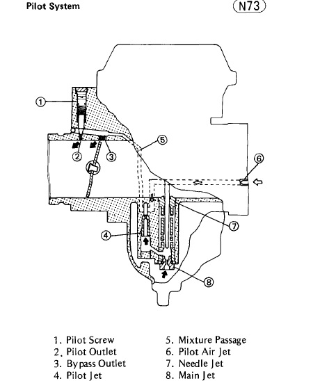

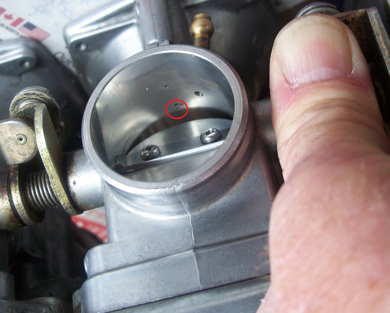

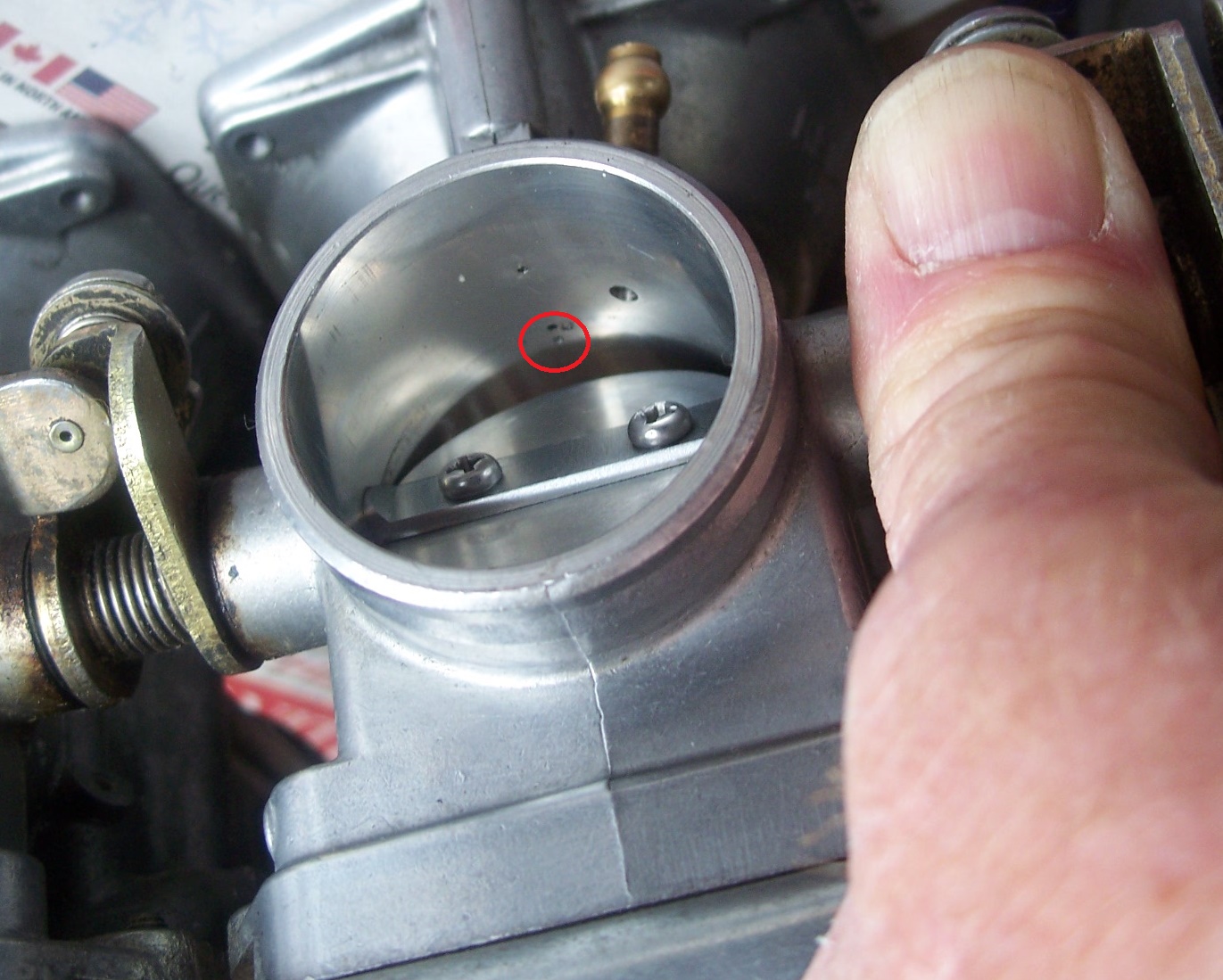

If you suspect the pilot system then have you checked for a blockage at the pilot bypass? #3 in the diagram below. A small pin or wire with the tip bent at 90 degrees can be used to poke out the 3 small holes. You may also be able to check if they are clear by squirting carb cleaner in 4 and watching (eye protection) for exit at 3
I had a bad stumble at 2500 - 3000 rpm caused by blockage here which I chased for months
I have same Keihin CV34 carbs
Might be something worth checking ?
