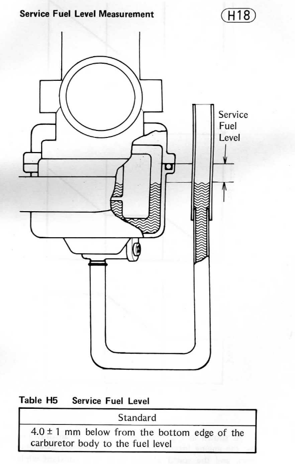

I didn't say float heights. Fuel level as detailed in the factory service manual. Did you check that?

Sorry, I was using the two terms interchangeably. The fuel level was correct before I took the carbs off, so I didn't touch the float heights, I just measured the fuel level again after putting them back together, and all is good.
I did the clear tube test on the float bowls and the fuel in each carb fills to the height of the base of the float bowl bolts, which is what is stated in the manual. The bowls fill freely and don't leak if the tap is left on prime.
