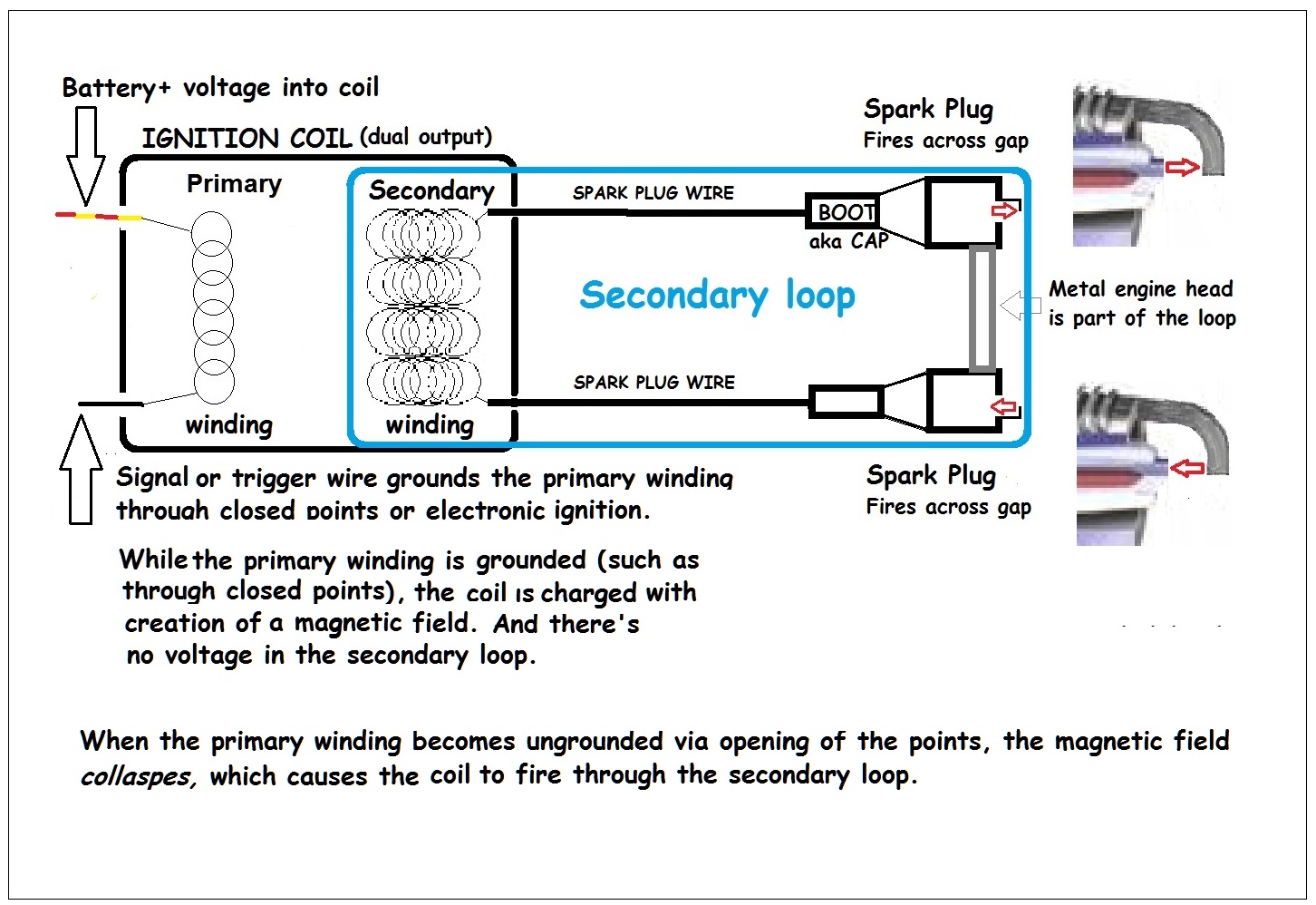

As known, running too rich may also result from non-carb issues such as ignition and/or compression.
Would assure correct ignition timing and proper functioning of the advancer unit.
With spark plugs removed, spin over the engine and check for fat blue sparks (not wimpy orange sparks).
As already noted, assure factory spec spark plugs (am guessing NGKB8ES).
Stock plug caps already contain resistors.
Do not add further resistance elements into the secondary loop (see illustration below).
Do not use "R" spark plugs.
Use solid metal core plug wires (not resistor wires).
More than one resistance element in the secondary loop reduces spark quality (thereby leading to inadequate combustion).
Old, hard, worn-out spark plug wires may leak high intensity voltage, which causes weak spark, resulting in less than ideal combustion..
As noted, would assure valve clearances within specs.
Would also perform compression testing.
And a leakdown test.
