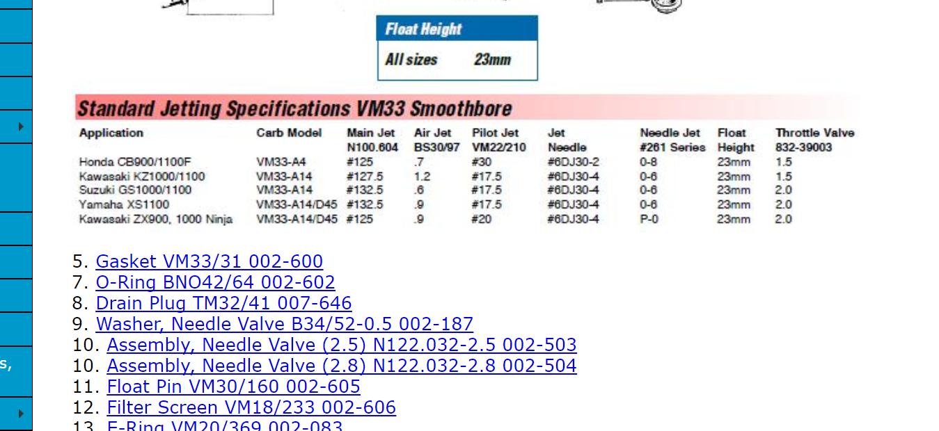

I am trying to order bigger jet pilots for a set of smooth bores 33 and the pilot has a marker and 2 numbers but I don't know if it is 25 or 52 So I guess that the marker indicates that but it before or after the number?

Before. What size do you need?

I guess I need 35 as the carbs have 25 and its lean in middle.

It has jet pilot 25 at the moment but those carbs were set up for a 1260 engine, now I put it on the 1400 big block I have and are a bit lean so should I go 1 or 2 sizes more?

I managed to get the needle out its a bit of fiddling but got it out, the needle its already with the washer put on the last one so can't be raised more.
when I first set them in the bike when it was going back to middle the bike was staying accelerated but few seconds.I did put a push and pull throttle and it got a bit better but still do it very slightly so I was told to increase the jet pilot 2 sizes with I am going to try now got 127.5 and 130 set to test.
If not I guess I will drop a new set of 40 flat slides on it and keep the vm 33 for the J model 1260 I am building.as those carbs were on that bike working fine.
