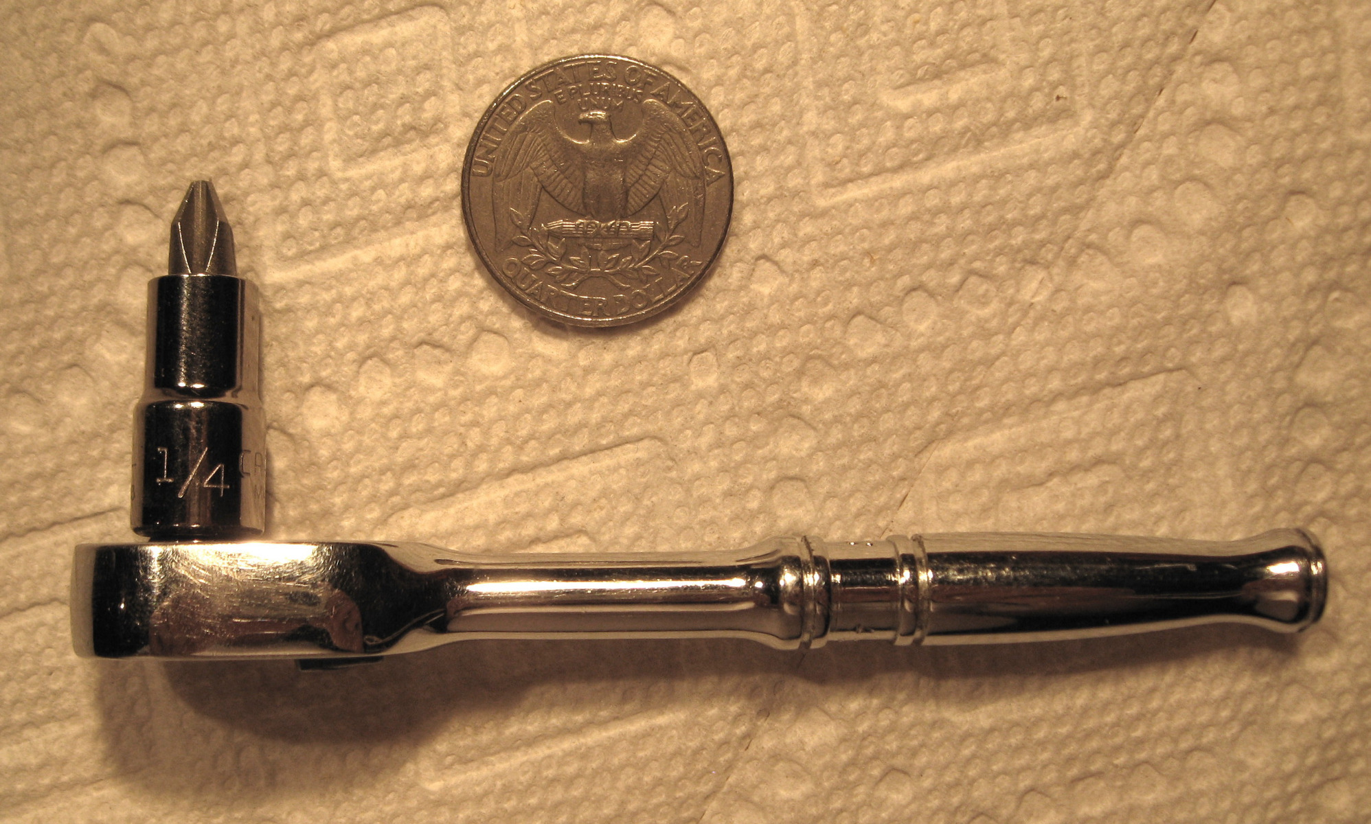

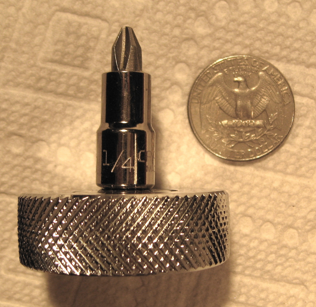

I wouldn't remove the carbs to set the float heights. You should be able to remove the bowls and floats without removing the carbs from the engine. I've removed the bowls from my carbs more than once using either of the screwdriver tools shown below. Ed
