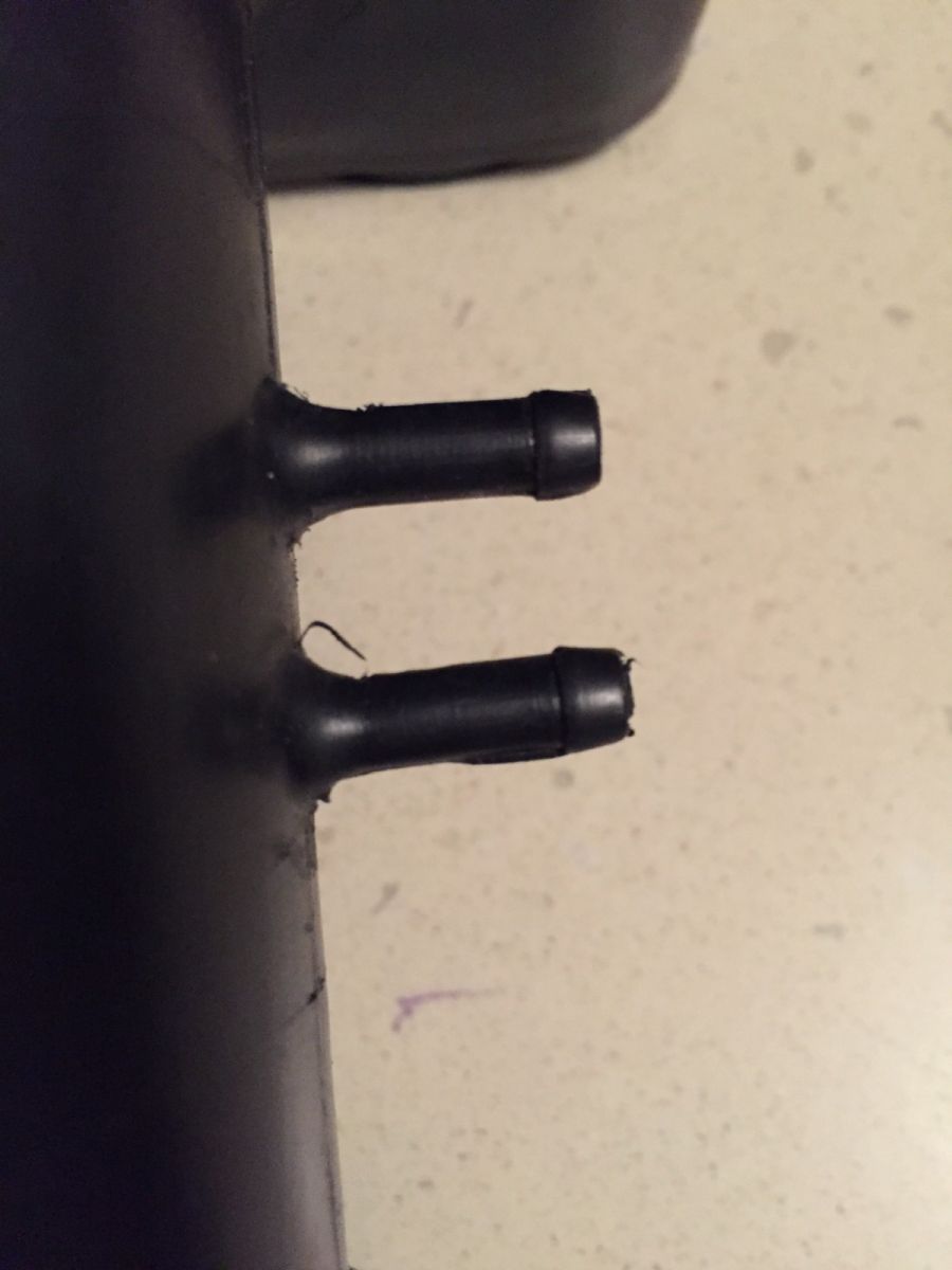

I'm not familiar with late 70's early 80's kz1000. What are these two post for on a kz airbox silencer. I've seen em always thought they were vent tubes but they are solid not for air vent . What are they

I have no idea what bike it is from, looks like a standard kz1000 airbox silencer. I can tell ya if someone plugged them, they did a hell of a job

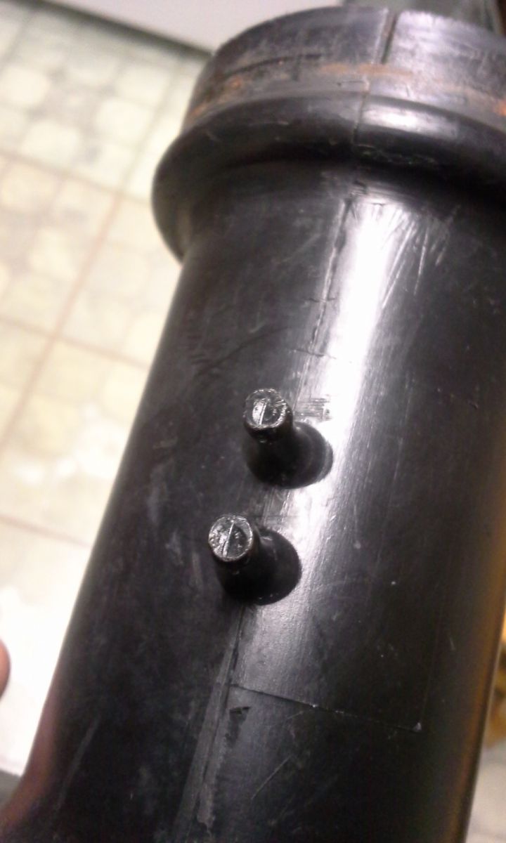

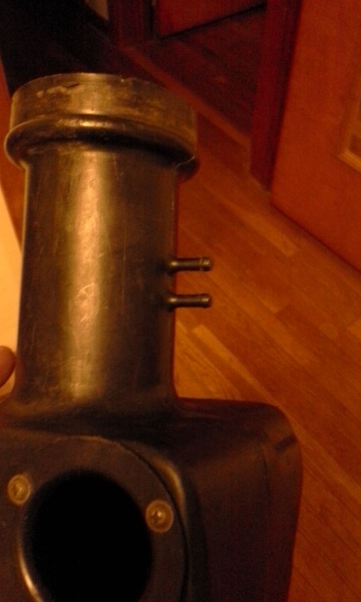

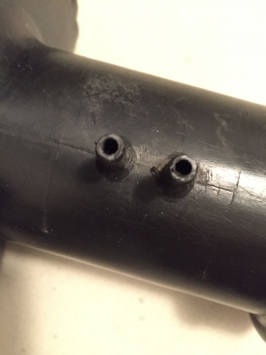

GregZ l've never seen one blanked before, all KZ1000's (US and Canadian markets) from late 79 when SMOG laws kicked in big time , have the 2 nipples to take tubes from the EGR Valve located under the tank, other markets got the non SMOG Z models designation, as Dragbike-Mike says most likely for a non SMOG market where KHI were using by then one fits all and the nipples were blanked off, does look factory blanked.
The one l pictured is from a KZ1000D 1980 Z1R.
[URL[/IMG][/URL]

[URL[/IMG][/URL]
