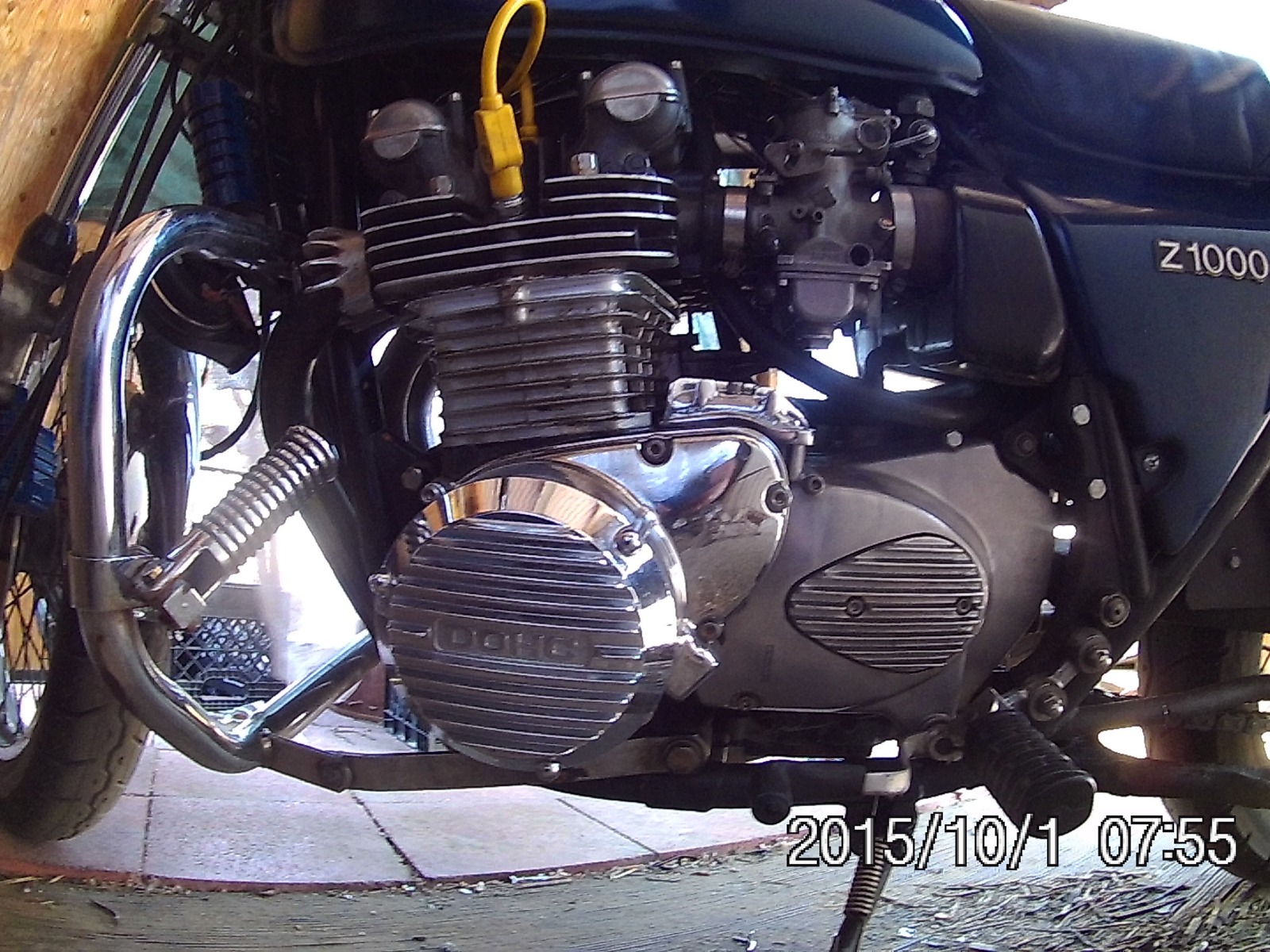

I agree. I went the pod route but went back to the airbox. When I got my 33's I couldn't use the stock Z1 airbox so I modified the KZ 900 one with larger radiator hose. The OD of the hose is a tight fit in a stock box. In my case I had to enlarge the holes for the larger hose. If you cant get stock boots than this might be the answer for you as well.
