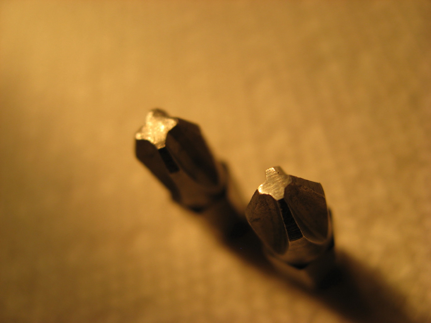

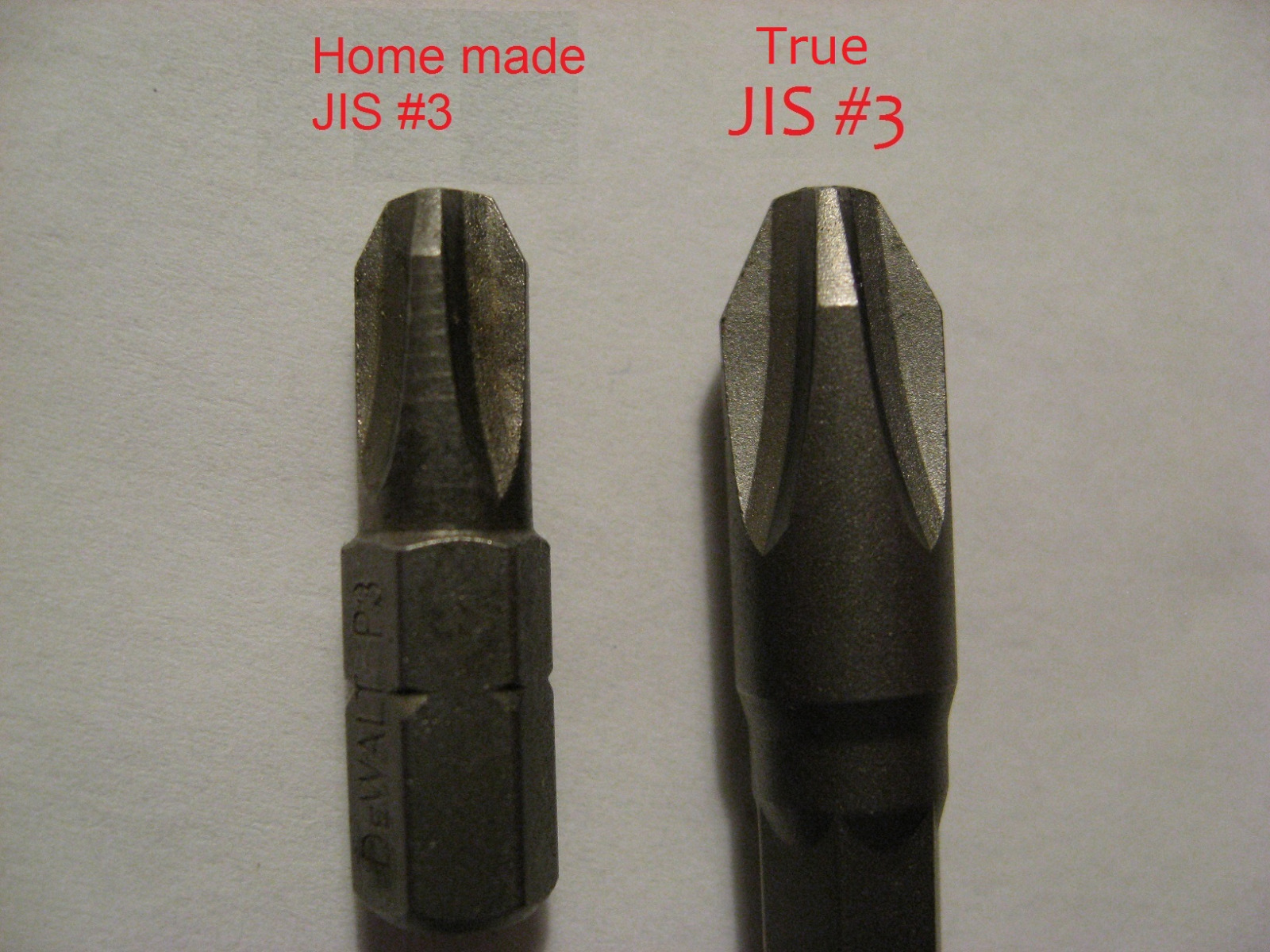

It looks to me like you tried to removed the screws using a Phillips screwdriver. They are NOT Phillips screws, they are JIS (Japanese Industrial Standard) and Phillips screwdrivers will not fit the properly (see images below). If it was mine I would first soak that screw with Kroil for 3 days. Kroil will break the bond between the screw and the cylinder head. While it is soaking I would buy or make a JIS screwdriver tip. The tip should fit perfectly, otherwise the odds of the screw coming out are very slim. Ed
