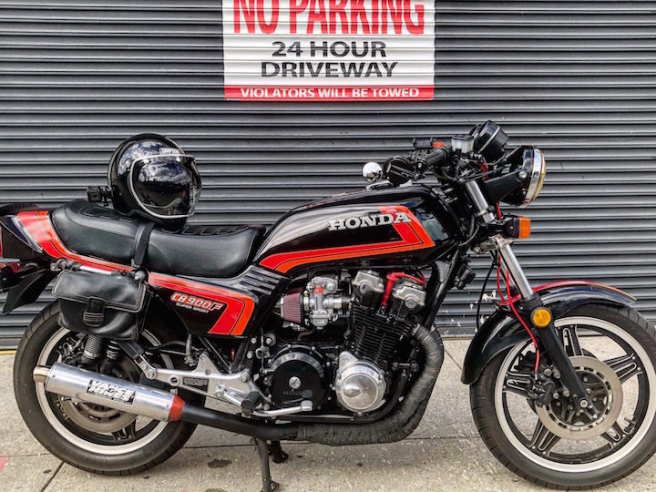

Im not throwing money at it to make the problem go away. I always wanted to upgrade to CR carbs like I did on my CB900f below. It was the best decision I ever made and I am strongly considering them for the KZ650. Sooner or later ALL of my bikes will have them. To me $1000 isnt a lot. My CB900F below had a problem NO ONE could figure out. Bike WOULD NOT go over 100mph. A guy in another forum told me it was probably carb, not spark related and highly recommended the CR carbs. I dropped the total of $1,400 on them and the pods and now the bike hits its top speed of 135-140. Im changing the spark plugs in the KZ650 tomorrow to NGK Iridiums. A friend and I looked at it (the bike) last night and could not find an issue, but one of the spark plugs was black as night - fouled.

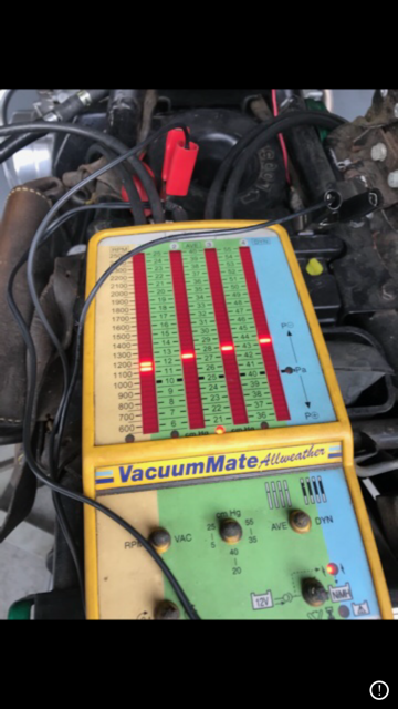

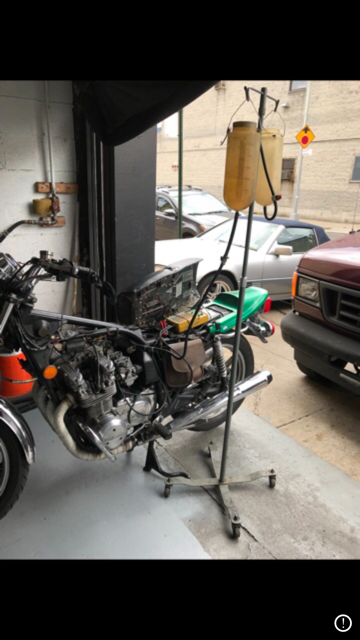

Valves were adjusted 3-4 weeks ago when I had the other issue that was sorted. Carbs were synched, valves were adjusted.

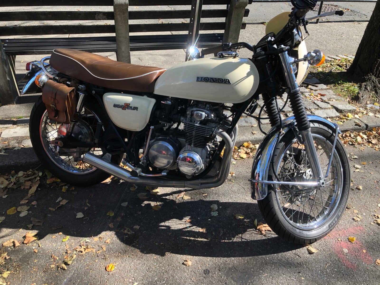

Thanks for this. So can I ask a dumb question?
On my Honda CB500 I had a similar issue as the previous owner used jets that were too big. The bike smelled of gas as well, and kept fouling plugs. The situation was fixed with I had the carbs rejetted.
These carbs are properly jetted and were synched about a month ago. Maybe something got stuck?
Im going to tap the carb as i know sometimes things get stuck.
Would all that fuel going into the combustion chamber taint the oil in a way that could causes hydrolock?
