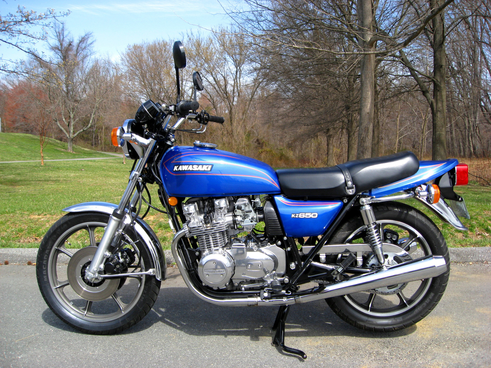

1. All of a sudden my 77 KZ650 has an OVERPOWERING smell of gas. I need to check out the fuel lines, etc, but its the holiday and cant sneak away. Perhaps I will get some time to check tomorrow. Even a police officer who happened to stop near where I was parked was like "wow I smell gas....a lot!"

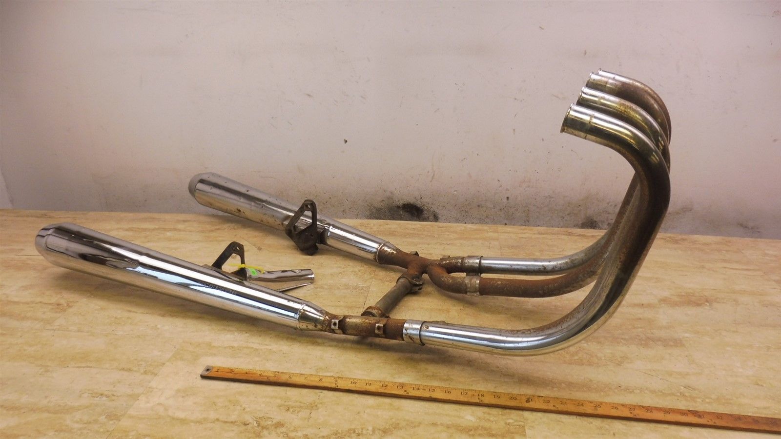

2. Tomorow I am ordering a Delkevic exhaust for the bike. By all accounts, its a pretty easy install. I have STOCK pipes on the bike now and saw this photo of the same exhaust on ebay.
Ive never swapped exhausts before, and it looks like this exhaust only connects at the usual header area and the rear footpegs. Are there any other places it connects?

No other mounts for the exhaust.
Might want to put something underneath the exhaust to support it while you loosen everything up.

hose and connection, but my kz650 still smells SO strongly of fuel that I got a headache when riding it today. AND my mileage has gone way down. I could go a few days and spend on $3 on fuel and now every two days Im dropping nearly $8 in fuel.
I dont see leaks ANYWHERE!
Could this be spark plug related?
A week ago I got over enthusiastic when using "PRIME" petcock position to start the bike. (the PO but an AFV valve and different petcock on. Its nice that I dont have to remember to turn it off) ...Thereafter I noticed exhaust pipe on cylinder one was cold. Took the plug out and it was black. So I swapped it with the spark plug in cylinder 3 and after that all the pipes get hot as they should. ....
Could the spark plug (s) be causing the poor mileage and gas smell, or is to think so a "stretch?
I have NGK Iridium plugs coming in the mail tomorrow so I will swap out the old, non-iridium ones. I have iridiums in all my bikes.

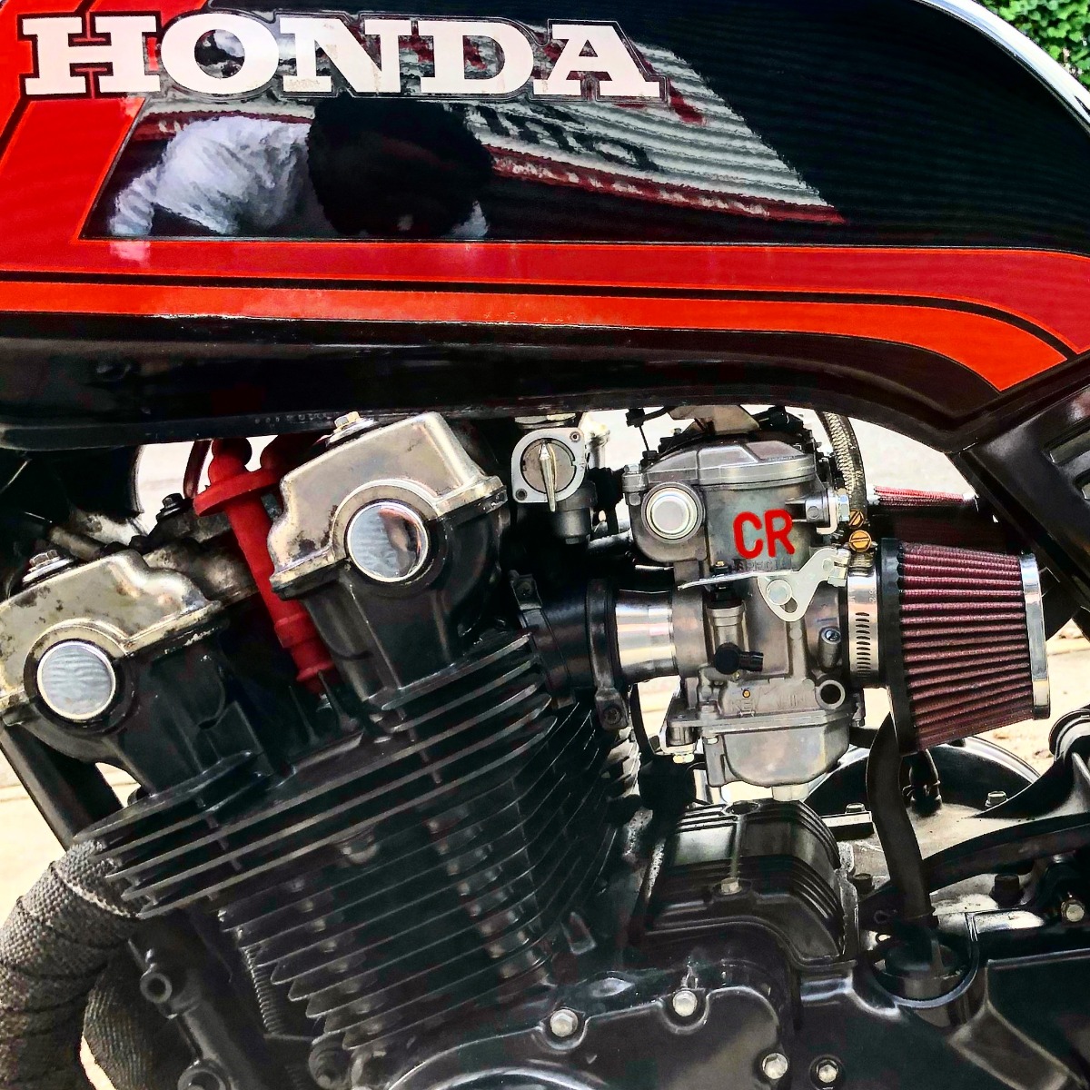

Ive had it with this carb rack. Im getting CR carbs pronto just like I did for my 1982 900F. Bye bye stock carbs. I just hope there is enough clearance to fit pods.:
