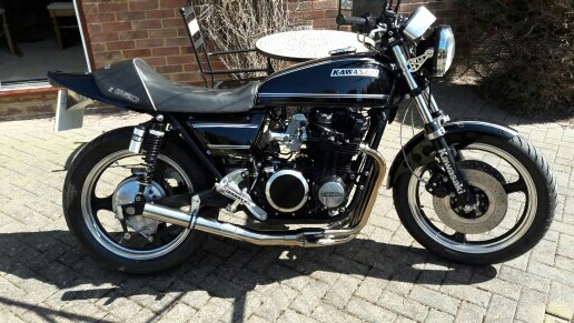

Not sure exactly how to tackle this issue, so I thought I'd ask the Gurus.
The bike is a kz650 with suzuki VM22 carbs. It had pod filters until recently when I put velocity stacks on. I now have a narrow lean band around 1/4 throttle. Every where else is perfect according to the AFR.
According to the VM carb Manual i need to swap the needle jet or the slide for a different cutaway size. According to partzilla, the suzuki carbs have a smaller cutaway (richer), so that is helping me. But the needle jet probably flows 5-20% (depending on exact part number) less than the 650 needle jet size around 1/4 throttle.. I have some kz650 vm22 carbs for parts ( pilot fuel needle seat damaged), so I could transfer over those needle jets.
Am I on the right track here? How do i press the the needle jets out without damaging them?

The carbs in your picture look like Mikuni carbs that would have come on a Kawasaki rather than a Suzuki. Take a look at the link below to see what Suzuki VM22carbs look like. Ed

pretty sure they're from a suzuki.
www.partzilla.com/catalog/suzuki/motorcy...rburetor-gs550b-c-ec
www.motorcyclespecs.co.za/Gallery%20%20A/Suzuki%20GS%20550.jpg
Also, they have pilot air screws and fuel screws which the kawasaki ones dont.
But thats all beside the point. either way I need different needle jets.
- Posts: 15336
- Thanks: 2833
Re: 1/4 throttle lean spot
03 Oct 2018 18:44
Thanks for the pics! I stand corrected. Ed
