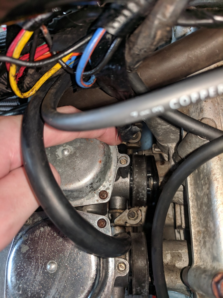

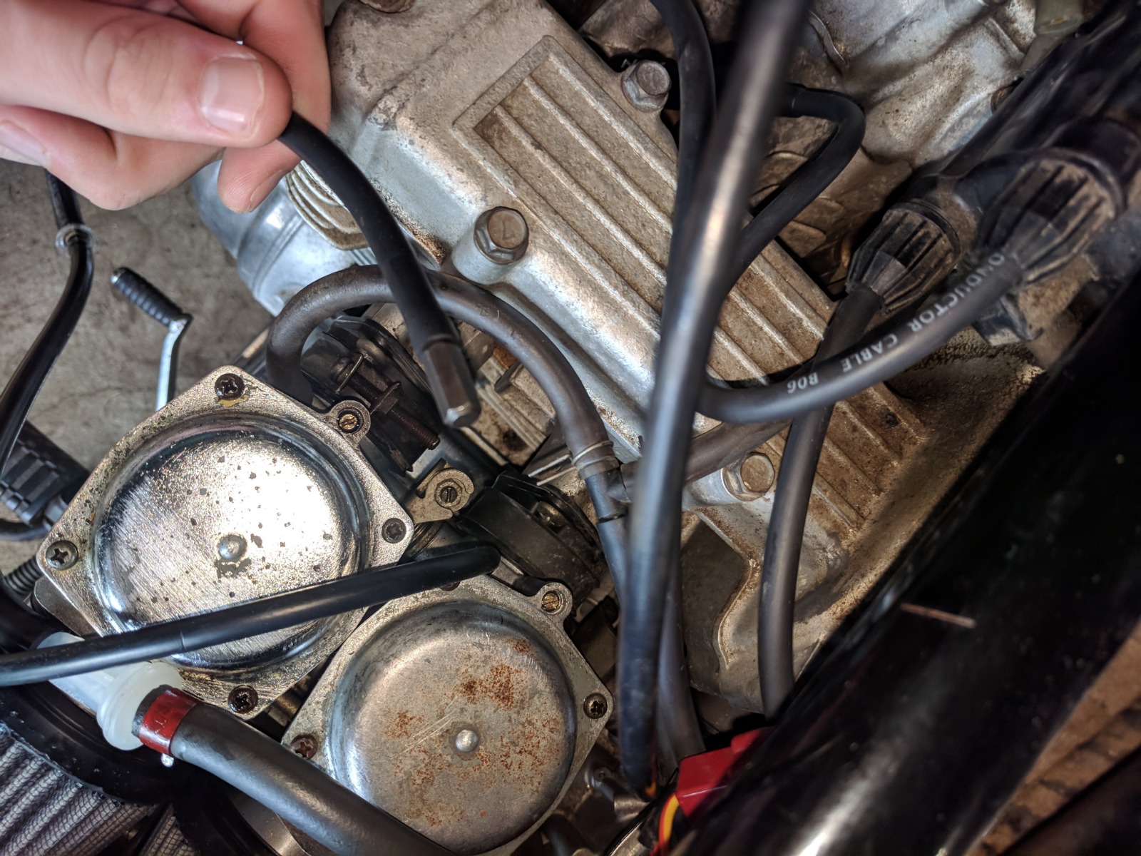

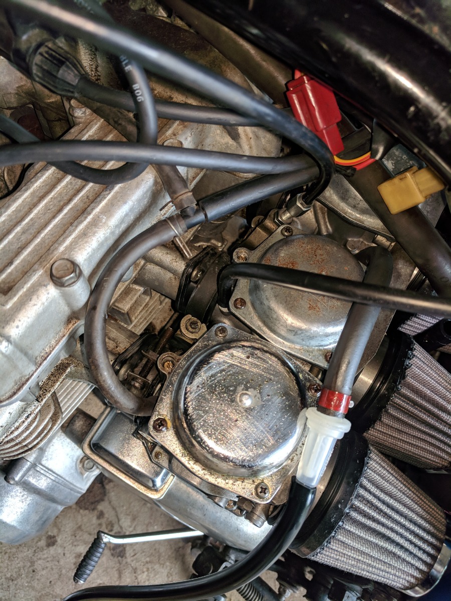

18 Aug 2018 09:52Vacuum line into carb 1 attaches to carb 4
Carb 4 vacuum line and carb 3 plug (where my finger is pointing
Carb 2 vacuum line that normally plugs into the petcock but is plugged because tank is removed.
