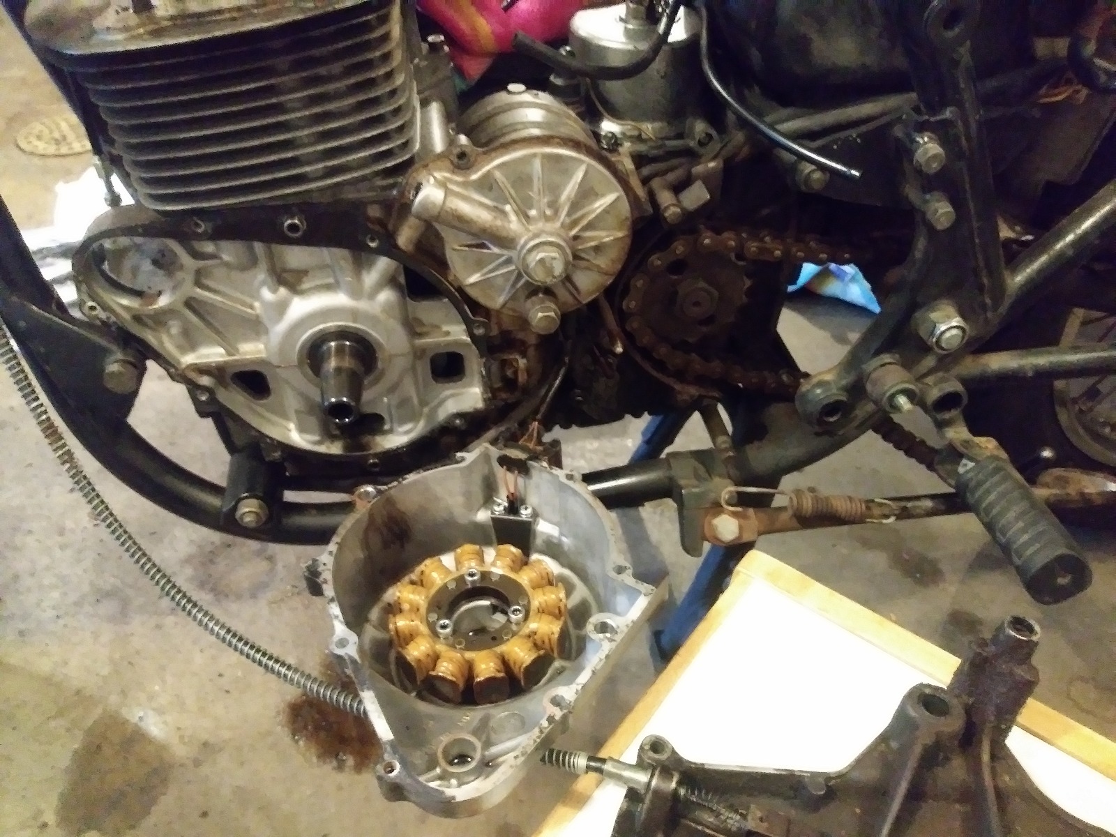

I got the bike back together it runs on 1/4 choke at 1000 rpm. But at choke off it runs at 3000 rpm. I am suspecting a vacuum leak. May be a throttle cable slack problem. Looking into everything carb. needs some carb work just got the carb rebuild parts in today. Looking forward to the first ride it is coming up soon. Any suggestions on diaphragms for the mikunis. It seems online they are 50$ a peice..... Got the side covers altough one is red... Minor cosmetic fix get it running like a champ first. Thanks for all the help guys. Z power out of UK had all the parts i needed Z1 had nothing.. Thanks Warren

Thanks Ed i have had the carb holders off when i had the head off. I did an inspection on them they seem to be ok. I am suspecting the airbox connections or throttle cable. There is a lengthy story behind this bike i have posted under im new here please help if you are interested in reading it. It smoked like thr dickins when it first fired up after 2 kicks. New head gasket new starter clutch it was seized due to a set screw backing out. Anyway i used to ride this bike all the time back in 2007 when i was 18 and i havent rode it since i am looking forward to a country road ride soon. I will rebuild the carbs and look into the carb holders more and the air box intake throttle cable. Thanks alot ed for the info. Keep yall updated and looking forward to a planned event soon possibly in Indiana or Ohio.
