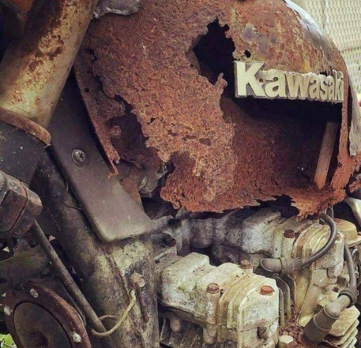

I disagree with the old theory of keeping a tank full to the brim to prevent corrosion. Unless the tank is in a highly corrosive environment. The biggest factor being garaged or not (surrounded by moisture or not).
Ethanol is what's causing the corrosion in today's fuel. And it's only happening while the metal is submerged. Just like dry carbs prevent corroded jets, same goes for tanks.
My KZ is 35 years old (always garaged), and it's spent several years at a time sitting with fuel in the tank. The upper portion which is typically above the fuel line is spotless, but there are multiple corroded spots forming at the bottom seams which have always been covered with fuel.

My experience differs from yours. I've owned my KZ650-C1 since April 1977 when it was on the showroom floor. I've kept fuel in the tank for those 41 years and I have zero rust in the tank. Before that, I owned a BSA for 11 years that was never garaged and had the same results.
Water is heavier than gasoline, so if the rust formed in the bottom seams of your tank it's possible (and likely) that there was some amount of water in the fuel that sunk to the bottom and caused the rust. Ed
