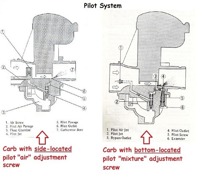

Do the carbs at hand have a side-located pilot air adjustment screw or a bottom-located pilot mixture screw?

Because it's a '78 I suspect the carbs have pilot screws, not fuel/air screws. I think in late '78 KHI switched to 28 mm pumpers. My B4 has pumpers but I replaced them with a set of VM 26SS carbs with fuel/air screws.

The screw is on the bottom. I think the stock setting is 1 turn out for the 78 kz1000 B2
