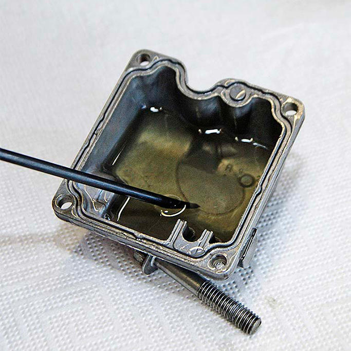

Hey All, have a 1995 KZ1000P with wet plugs and pistons on Cyl. #1 & #2. Both of these cyl. have trouble firing. Ordered a complete carb rebuild kit, but have cleaned these things about 4 times already over the last 2 years. New O-rings, floats, etc. Gonna run a guitar string through the idle circuits one last time . . . this is getting old. I can now have the carbs off the bike in about 5 minutes.
With rebuilt top end the compression is 155-160 (yeah!) all around and ignition looks good via blue sparks. Never seen this before, as the "wet" is not oil or gasoline, but appears to be WATER? This is an air-cooled bike! All I can think is condensation? Maybe it is gasoline but I can't smell it cause of the exhaust in the air?

I would drain the tank complete empty and dry him with a heat gun to vaporised the water. Remove the petcock and give him a good clean. Catch the fuel in a big transparent bucket. Water is heavier than fuel and will stay on the bottom of the bucket. If you have water in the float bowls the water will replace the fuel in the jet area.

The only way you'll you'll get water in the carbs is either water in the gas from the filling station or from cleaning the bike if you have pod filters.
Water in the tank from filling does happen, its happened to me twice in cars. It doesn't need to be a new station it can be contaminated anywhere in the chain from the refinery to the pump.
Water in tank from jet wash cleaning, is from over zealous cleaning if air filter pods are fitted. You should never clean the filter pods with water or a jet wash especially. The filter elements should be lightly oiled to stopped dust particles, cleaning them whilst cleaning the bike removes the oil and fills the bowls with water. Cleaned your bike recently?
No carb or valve settings would make the carb bowls fill with water.
If the plugs and pistons are wet and it is water, it'll have come through the carbs. Dump that tank of fuel, and clean the carbs, refill with fresh fuel.

Fuel is like like break fluid and has hygroscopic properties. In other words, over a long time period every tank can have an enrichment of water in the bottom, specially on carb bikes that do not have a fuel pump system. Injection bikes have a fuel pump system that permanently circulate the fuel in the tank and injection system, (fuel pump/filter/injector jets). Fuel and water particles get mixed and injected in the combustion camber, with a little cooling side effect.

Have you ever seen that "gas line antifreeze" called Heet Water Remover? It absorbs water, which then mixes with the fuel.
Where I live, gasoline is 10% ethanol, which is basically like adding one bottle of Heet for every gallon of gas. You would need massive amounts of water in your gas, before it would separate into separate layers of gasoline and water. You may not have ethanol gas, but you probably have a gas station which sells E-85 (85% ethanol, 15% gas). It's handy for rinsing a tank after an acid wash, because it absorbs all the water; but once you pour it out, you can add gas. No need to dry things off.
