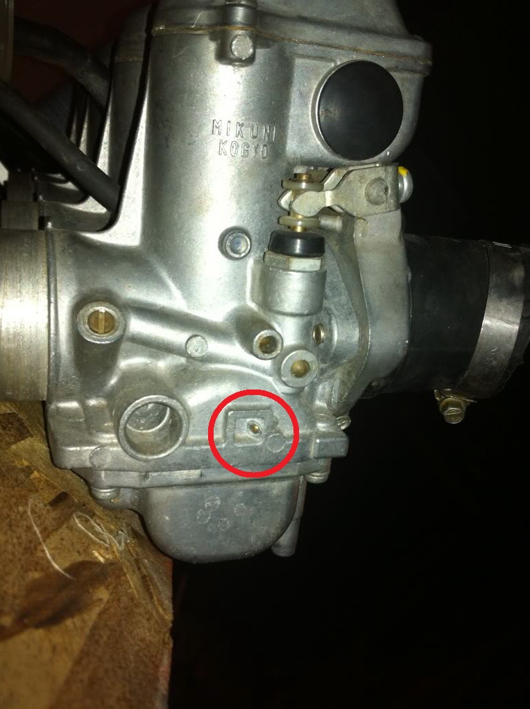

If your carbs are smooth bores they will have this square casting on the right hand side.
Backfiring is more likely to be firing order or valve seating issues.

That's them.
