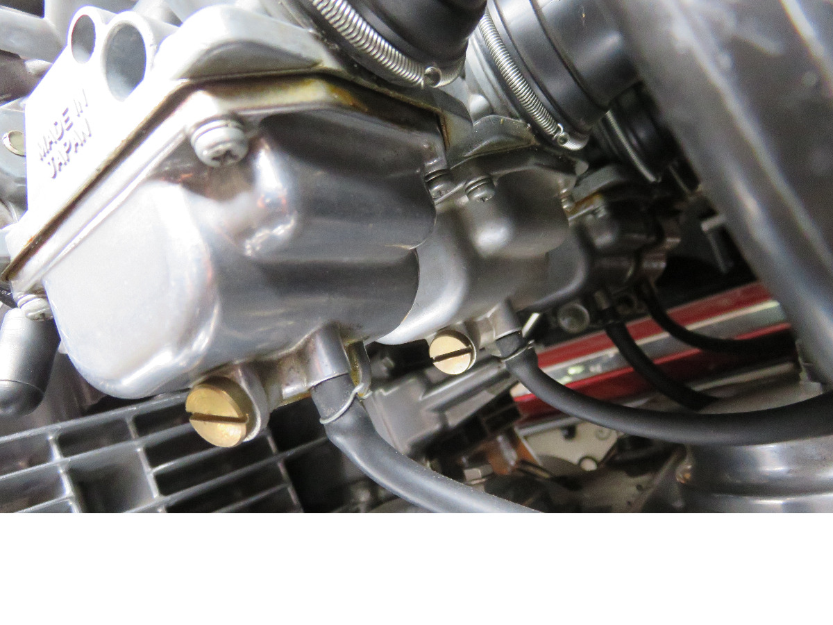

21 Jun 2018 14:39gordone wrote: Hem.., so then the previous owner has used wrong needle!
Just to be 100% sure if you take a look at my first two picture today, we are sure I have VM24?
They appear to be VM24 carbs, but the float bowls are different than the ones on my carbs (see image below). Mine are original on my 1977 KZ650-C1, maybe yours are from a later model KZ? Ed

Re: VM24 carburetors float needle?
21 Jun 2018 23:07650ed wrote:gordone wrote: Hem.., so then the previous owner has used wrong needle!
The bike is from 1981 and the carbs I think is the original who was used in the orginal 650cc engine.
I can see that you all not agree here what I shall go for.
When I try ebay on K&L 18-8956, then I got needle who is identical to what I have today (sure its possible to be looking at a picture).
I have had problem to adjust the level perfect on some of the carbs, so I think its a good idea to change the seat and the needle.
I will also verify the bowl is not leaking when I rebuild these.
Are we all agree that 16030-1001 will the best option if I can find to a okay price ?
Or is there option I can go for who will me almost same quality and save alot of money ?
