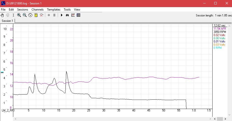

IT LIVES ha ha ha ha
It started easy idle needed adjusting until it warmed up , I gave it a couple of blips and took off down the road,
Its definitely got a small flat spot down low . but once that cleared it took off. I didn't go past 7000 as the wide-band kept on cutting out from a bad power connection, but heres the first LM-2 data log synchronizing the Carburetors, i started turning down the idle at 25 seconds
Black line is RPM , IT didn't need much tweaking but i did spend a bit of time bench setting them.
After speaking with Marc at Factory Pro i will be sticking with their jets , the Australian DJ distributor doesn't sell jets

Looks good and the air/fuel is pretty flat.

So the AF idle chart looks alright? this is my first time rejetting its all a learning curve. Am i right and this will stay the same even with main jet and needle changes and will only need readjusting if i change the Pilots .

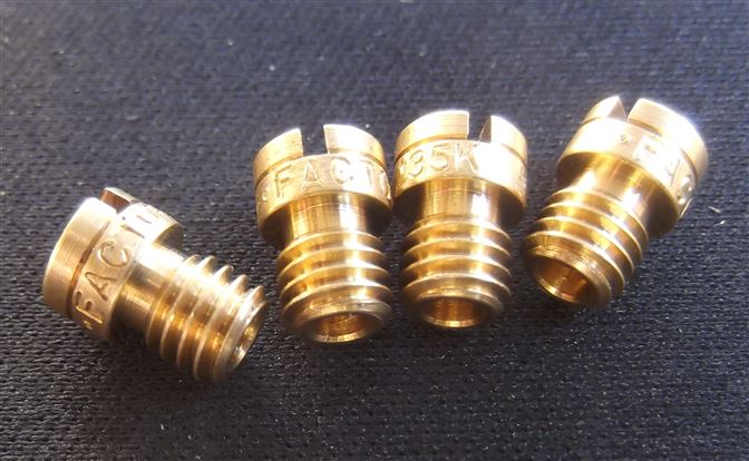

I also finally found a company over here who stocks factory pro jets and ordered a set of 135's going by Coreys set up.
