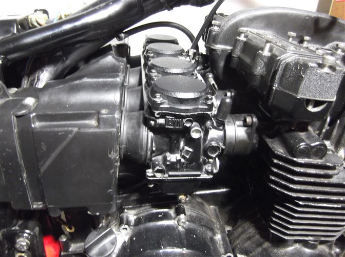

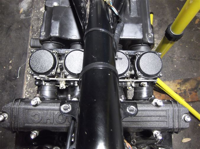

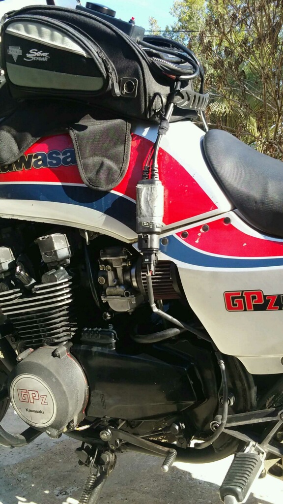

i set up my spare empty cases, block and head in the frame and test fitted the carbs. I am still waiting on parts for the actual engine i will be using
I wasn't expecting the air box to fit but there it is,
They also use a single pull cable instead of the push/pull arrangement on the 600's

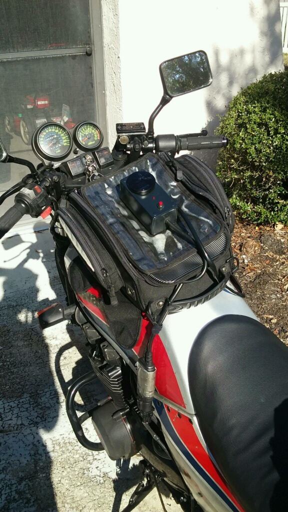

I'd recommend buying a wide band and tune for road use. I've posted this before but here is what I have yet to install. A good friend of mine has been using his Wide Band to tune his CV32 Carbs to his 12:1 615cc and Web Cam Engine. He is such a good friend, that he will not help me with additional jetting questions on my set up, till I have the LC1 installed. He says using it will answer most of my questions. LOL!!!

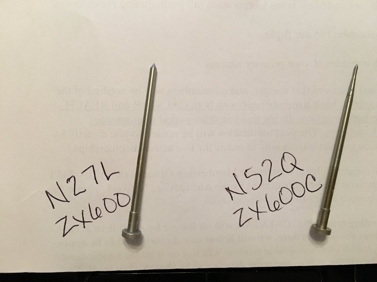

In this picture, I am using the needles on the right with shims added. Tomorrow I will have the carbs off, and will list my current settings.
www.innovatemotorsports.com/products/db.php

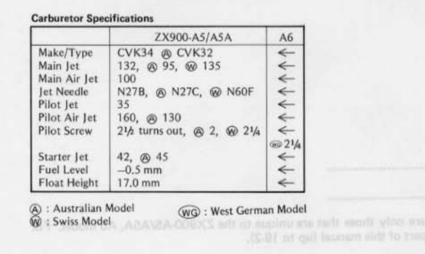

These are CV32 ZX900 carbs, check out the attachment in my first post, australian 900's got the 32s.
i thought i was getting a 600 set. clues are black paint, single pull cable. jets, needles
I just cant see that 90 main being any good for power, but maybe im wrong

the N27C needles look more like the N27L than those pointy 52Q's your using

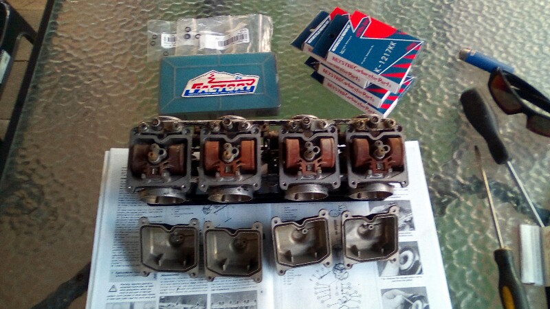

now that i have sorted the clutch i can get the carbs ready for tuning. so i have bought
o rings for the fuel and vent tubes
zx600 factory pro jet needle kit i found for half price
keyster gasket float valve kits
i think that should cover it other than a few more sets of mains
the engine has kz550 timed zx550a cams.
10.5:1 comression
4-1 exhaust
Modified stock airbox uni filters

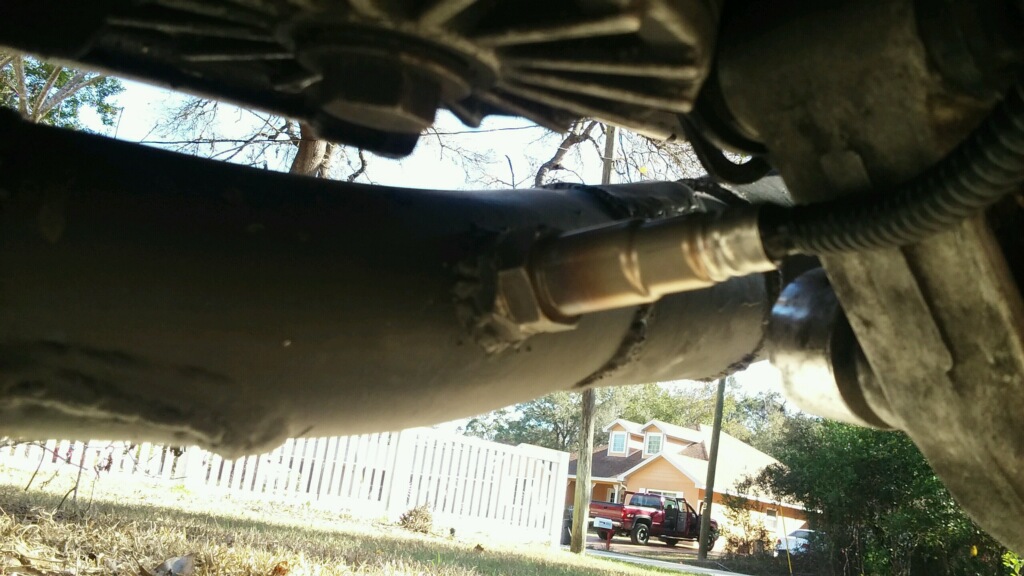

I have also welded an O2 sensor bung onto the exhaust so i can use a LM2 to dial it all in.
Before I order some more mains should I also add some 38 pilots to the list. I see Cory is using 38's but the pilot airjets on his cvk32's are larger than my set or should I just wait and see how many turns the pilot screws end up needing.

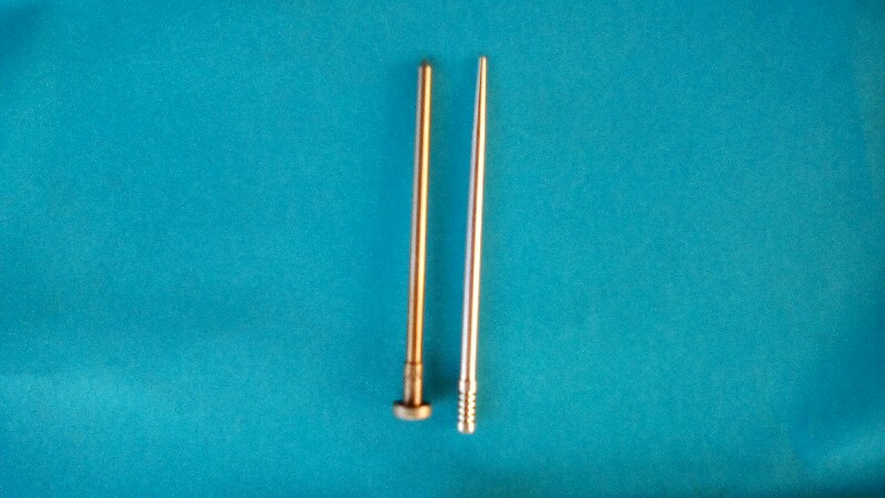

old and new needles
10.5:1 comression
4-1 exhaust
old and new needles

What is stamped on the needles you are showing on the right above? N27L???

ok thanks Corey. I think i will get some just in case, i cant find anyone over here who sells new jets just used ones so i need to order them from over east or USA
The Factory pro needles are 0964g-76p-40t.2 for richer at 5000 to 7000 the recommend getting 0964g-72p-40t.2 needles

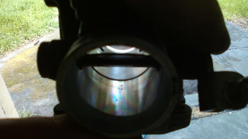

these 32's dont have holes in the butterflys and all look identical with 3 bleed holes.
edit. using phone so photo is not the best
