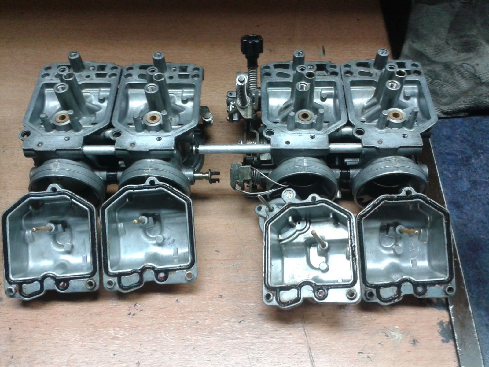

Hey, new to the forums and bike world.
The bike I’m working on is a ‘76 KZ900 which hasn’t ran in over a decade. Threw dynas electronic ignition on and got spark back, compression test went well, and I’m currently rebuilding the set of mikuni carbs. After looking down the spark plug hole the top of the cylinder is really dirty and instantly through of sea foam as a cleaner.
This is probably a silly question but I need some others voices on it. Sea foam and freshly rebuilt carbs will be alright correct? I also see that you are able to clean the crank case with it or with the kz900 it’s the “chain oil case” correct? I’ll be replacing the chain after I get the bike running so I can run the cleaner th right then replace the chain.
Has anyone had issues with seafoam or any other cleaners? Any better methods of cleaning up the combustion chamber/crank case other than running it before and oil change?

The one problem I have read about with Seafoam is when folks do not follow the instructions on the can. Instead of using the recommended amount per gallon of fuel they put in too much, then they are surprised when they have problems with the engine not running well. Be sure to use only the recommended amount per gallon of fuel. Ed

10 Feb 2018 07:14Assure that carb cleaner spray exits into orifice #6 into the carb bore.
An obstructed orifice into carb bore may be stubborn to clean, and perhaps not cleared via ultrasonic soaking or other methods other than rather forceful spray as indicated in the above diagram
