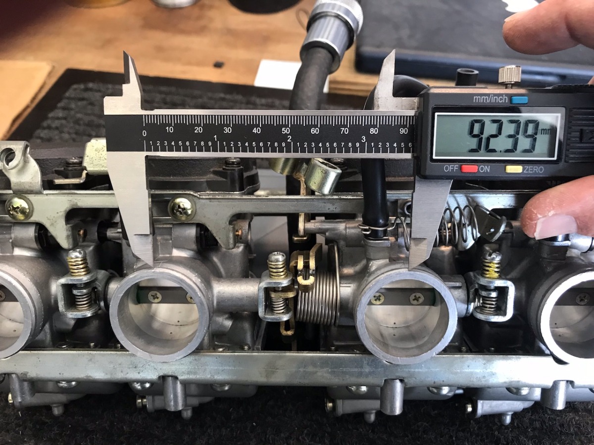

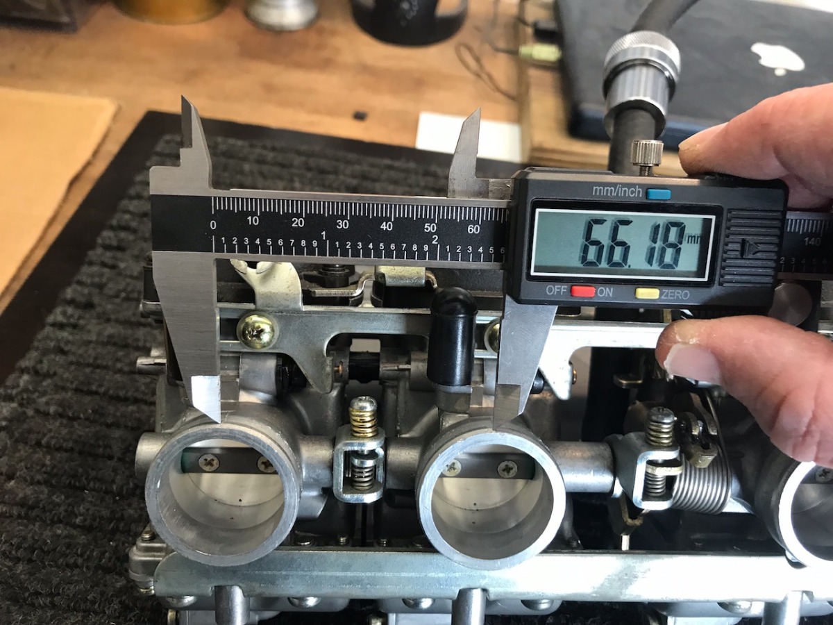

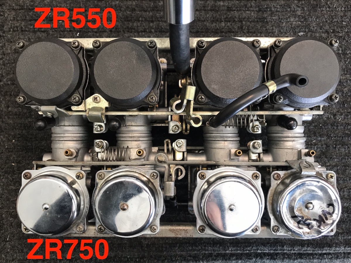

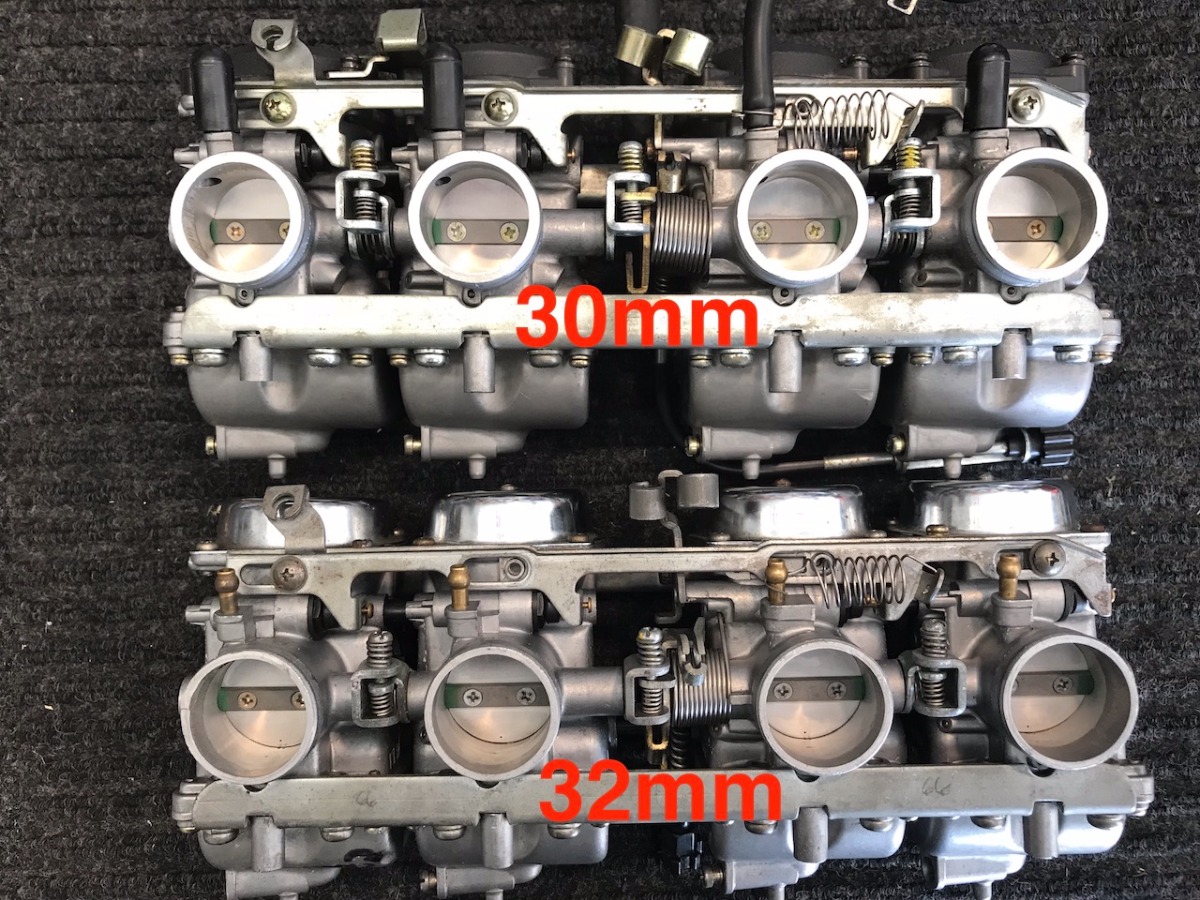

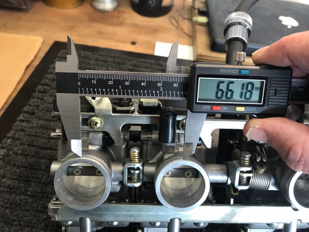

- Daftrusty
- Posts: 377
- Thanks: 210
Re: Modern carb suggestion?
31 Oct 2017 13:05 - 31 Oct 2017 13:08loudhvx wrote:From posts in the past, others have said the carb spacing on the Zx600 matches the carb spacing on the Kz/Zx550, which the 600 was based on. I thought the Kz750 spacing matched the 650 spacing, which matched the 1000 spacing. Did they make the Kz750 spacing different than the Kz650?Daftrusty wrote: The Keihin cvk32 carbs from a Zephyr 750, zr-7 or zx600a/b/c will work.
The zx600 carbs are very easy to find and for much cheaper. ...
They have identical carb spacing to the zr-7 and Zephyr carbs. ...
I know, as I built a set of 1994 zx600c carbs for mine after getting e-screwed on a set of Zephyr 750 carbs.
I run a Stage 3 Factory Pro jet kit because I have pods and 4-1 Kerker.
Someone on a Honda forum posted this as the Zx600 carb spacing, which is even closer together than what I measure on the 550.1&2 and 3&4 (c to c) -67.5mm
between2&3 (c to c) -91.4mm
I measured several 550 carbs and the spacing was
1&2 and 3&4 (c to c) 71mm
between2&3 (c to c) 92mm
The Zephyr 550 & 750, zx600a/b/c, and zr-7 cvk32's all use the exact carb spacing of 66-92-66 as measured by the exact centers of the bores.
They all use specifically offset intake boots that are different between the 550's and 750's. (the zr750 and zr-7 boots are identical)
As the cylinder head intake ports on a zr550 are identically spaced as the kz/gpz550 heads. Same with the zr750's and kz650/750's. They all just use different head-to-carb boots to accommodate the different carbs through the years.
