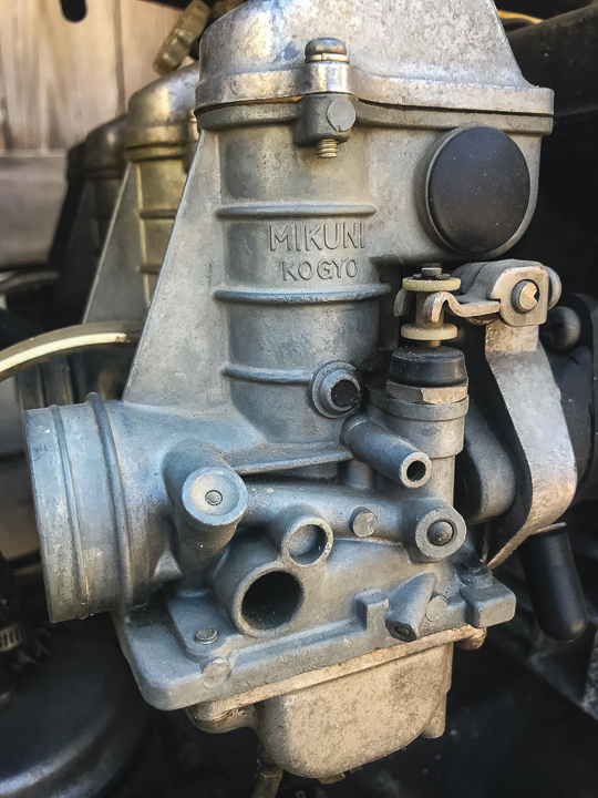

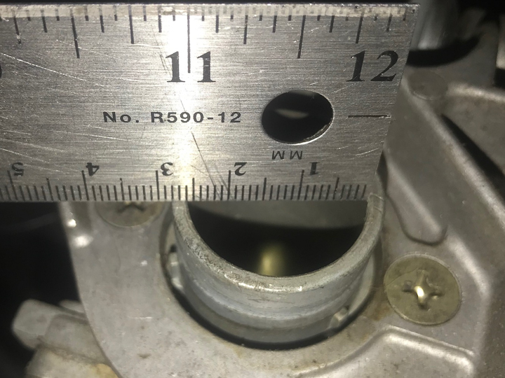

I picked up a non-running '77 KZ650 today. Started the tear down and found that I have a '82 750 engine installed already. Unfortunately, I do not have the Keihin 34 carbs. I have what visually looks like the Mikuni VM24, but I'm measuring them out at 26mm on the head flange side. Do I need to use an actual dial indicator and get down into the boar to measure them out accurately?

Looks like 24's. They should work. The CV carbs are more forgiving of elevation changes. Harder to tune with pods though.

They are 24s you measure them right down in the throat, you will need new boots either side of carbs, they will also need rejetting and will tune with pods unlike CV's which won't.

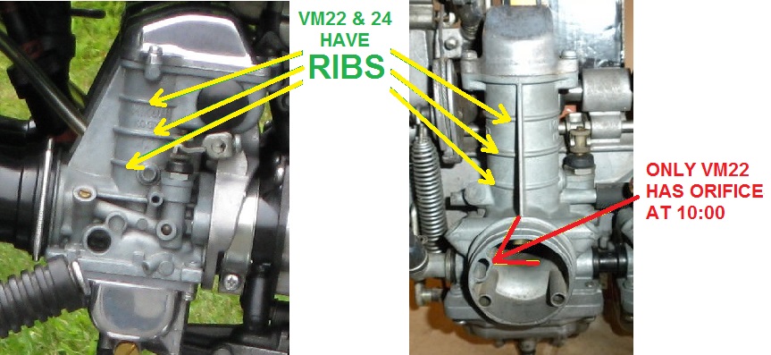

If those carbs originally came on a 1977 KZ650 they are 24mm Mikuni VM24SS carbs. If they came on a 1978 KZ650-B2A or D1A model they will be 22mm Mikuni VM22SS carbs. The 22mm carbs have the extra orifice at the 10:00 position of the intake throat as shown below; the 24mm carbs do not have that orifice. Ed
