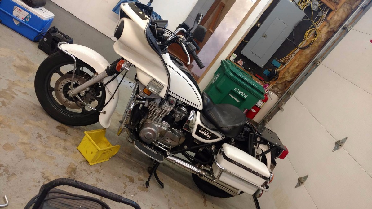

So I recently just built an exhaust for my 2005 kz1000 police, it's pretty much a straight pipe with a small amount of back pressure because of the cone tip I welded on at the end. I'm wondering whats a good inexpensive jet kit out there that works well for the money. I'm not trying to build a race bike, I just want the air fuel mix to be right and not lean? Also how well do pod filters work on a late model kz1000p like this with the cv carbs? Thank you for all the advice ahead of time.

Putting pods on CV carbs will ensure you get to spend plenty of time trying to get them to work as well as the stock air box. Be sure to post the magic formula if you succeed as inquiring minds want to know.

DynoJet and 6Sigma make jet kits.
They have different stages that relate to what has been changed on the bike.
Stage one is for a stock machine. Stage three will be for filters and exhaust.
DynoJet is the most complete. 6Sigma does not have a jet needle. If you search the archives
for BS34 jet needle there is a post about a different needle some have used with success.
I don't know if there is a kit for a police bike specifically but any '81 and up 1000/1100 kit will work.
