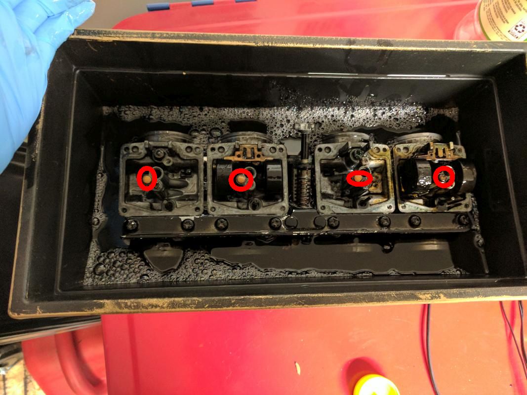

Additionally, the carbs were in awful shape. I've seen some bad carbs before, but these were awful. I used the (original recipe) Pinesol soak method with an aquarium pump and heater to warm the solution and circulate it.
Post soak - they cleaned up surprisingly well

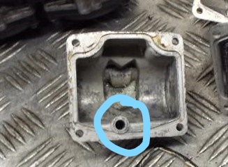

One thing that gets overlooked a lot is the enricher jet in the float bowls, if it's blocked you can't start the bike without a long fight, I know this from experience.

14 Sep 2017 06:16kevski wrote: One thing that gets overlooked a lot is the enricher jet in the float bowls, if it's blocked you can't start the bike without a long fight, I know this from experience.

The jet i mean is the one in the float bowl where the brass lift tube goes down, it's pressed in and cannot be removed, if the bike has stood a long time and the fuel has evaporated these block up and can be hard to clear, if you fill up the large part of bowl and it rises up this hole it's ok, if not the jet is blocked, this may not be the same as your carbs but it will have the same sort of thing down in the encircled hole.

14 Sep 2017 09:55kevski wrote: The jet i mean is the one in the float bowl where the brass lift tube goes down, it's pressed in and cannot be removed, if the bike has stood a long time and the fuel has evaporated these block up and can be hard to clear, if you fill up the large part of bowl and it rises up this hole it's ok, if not the jet is blocked, this may not be the same as your carbs but it will have the same sort of thing down in the encircled hole.
Ah, ok, yes. I was sure to clean these ports as well. I went through the damn things very carefully with carb cleaning wires and air...but I'm just starting to think it has to be a fueling issue. I am certain that I have 3 of the 4 components needed; Air, Compression, Spark, and Fuel....fuel is the only one that I can't be certain of. The plugs are dry even after repeat cranking...so maybe something is still clogged?

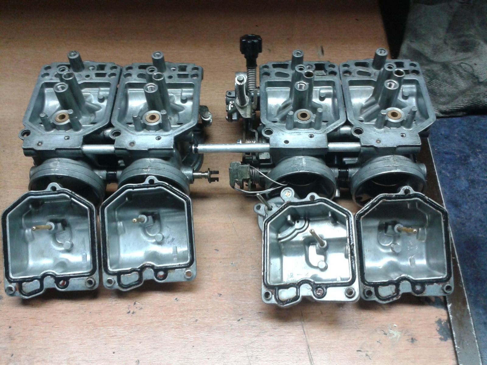

You have to separate the carbs for a better cleaning result. Never put brass,steel and aluminum together in a chemical dip!!!
Have you look under this plugs? Maybe some uncleaned jets. I could be wrong but i have to read something about this plugs/jets..
This is my kind of carb cleaning chemicals, i have best results with it.
