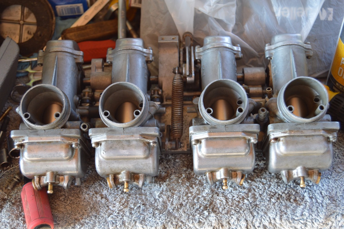

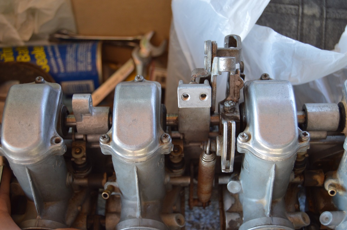

Hello all so this is the first time I have posted on anything since getting my bike. I traded $400 worth of musical instruments for it about 5 years ago then turned around and sold it after getting it running to pay for my wedding. Well as things turn out I just got it back this year for free because the person I sold it to sold it to someone else who stopped making payments and robbed parts off the bike....
Now that the history of the bike is kinda out there, I am having an issue with my idle. Well after looking at many different pictures and reading many different things I have come to find out that the Throttle Stop Screw is missing. I am talking the whole complete assembly, bracket, spring, and the throttle stop screw itself. I am having a hard time finding this part anyone have any ideas? or have one for sale?
Oh and this is the third time I have resurrected this bike, all three times the bike was not running when I worked on it. I am not a motorcycle mechanic and technically this is the first one I have ever worked on. So laymen terms and part numbers would be helpful please. Thank you in Advance!

Anyone know which set of carbs I have? Also was wondering if anyone knows the part numbers for the throttle stop screw, spring, and assembly?

so the part numbers are 16077-013 HOLDER,THROTTLE SCREW, 16021-028 SCREW,THROTTLE STOP, 16022-017 SPRING,THROTTLE STOP
Looks like I can get the spring, and screw off ebay, but I can't find the holder anywhere.

Looks like you need reference number 23. Note that it uses a different screw than the earlier models.

If you click on the part description, you will see this useful information ..
