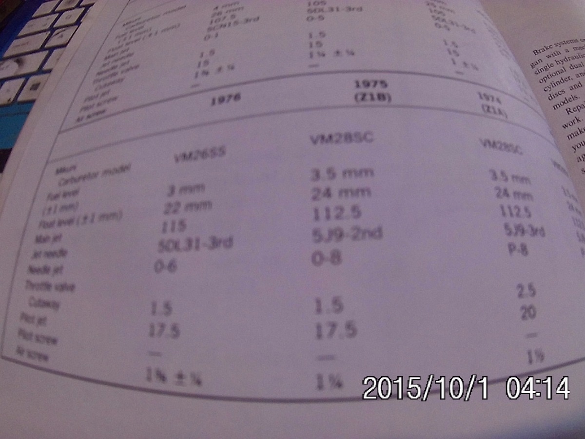

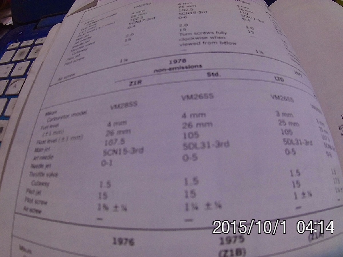

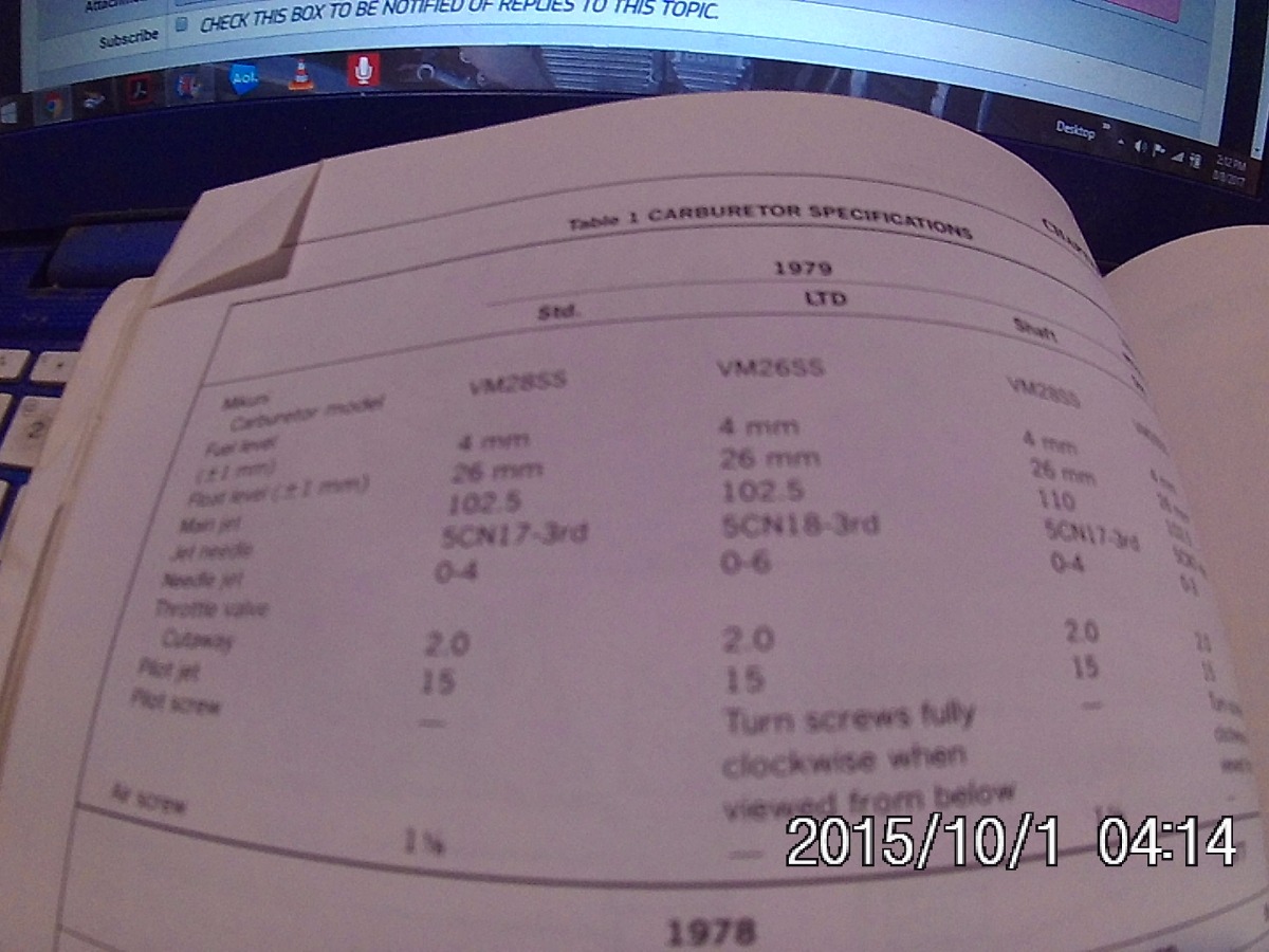

Looks like the 79's have 2.0 slides. (lean) The air screws are 1 1/8-1 1/4. Opening the screws makes them leaner still.

Re: KZ900B Tuning Help
08 Aug 2017 15:39
If they're fuel you should be able to hear when you get best idle. One turn is 360* of movement. Try 1/18 and go out accordingly. It says turn them out clockwise from looking at them from the bottom. Stock is 1.5 cutaway. (rich) Others have 2.0 slide cutaways. (lean)
