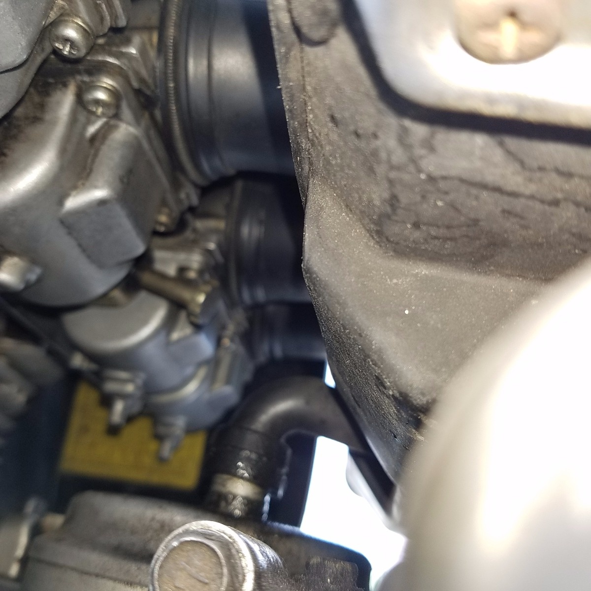

I understand. No problemo, it is awkward to get a vid of it popping out by myself and reving it. I have included a pic of the choke set up.on this. I lnow the knob is broken off. Please look at this and see if it is correct. Should the little spring be on the outside of that bracket and helping to hold it in? My manual isnt real clear in its pic of choke knob. setup. And what is the thumbwheel in the center of the 4 carbs coming out the back of carbs? Kinda hard to see.

That's the idle adjustment screw. Looks liike you're missing the snap ring on the choke plunger.

Something like this.
jetsRus.com
jetsrus.com/choke_repair_kit/choke_repai...election.html#street

and the snap ring on my setup would be directly under my missing black knob?

No eBay APP ID and/or Cert ID defined in Kunena configurationHere's a pic. No snap ring I can see.

and the u shaped little steel chanel piece looks strait on the ebay one compared to my bent u shaped little steel channel piece. hmmmmm
