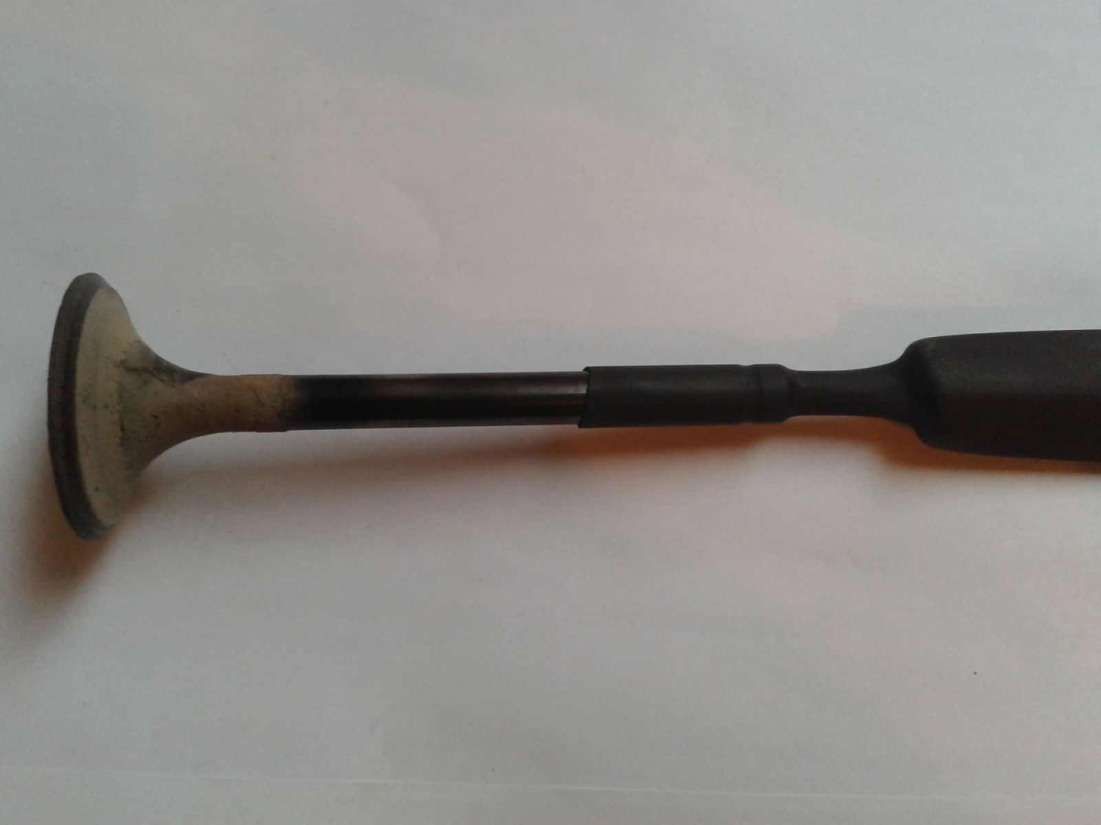

Nessism method is right and will work more or less but the tees rubber will dry out over a short period of time.
The tees rubber will lost tension and leaking again. The shrink tube gives you a little more preload to prevent leaking.
Its a PITA to do it twice, i speech of experience.
You need only a 20 cents piece of 4 inch long shrink tube to get on the save side.

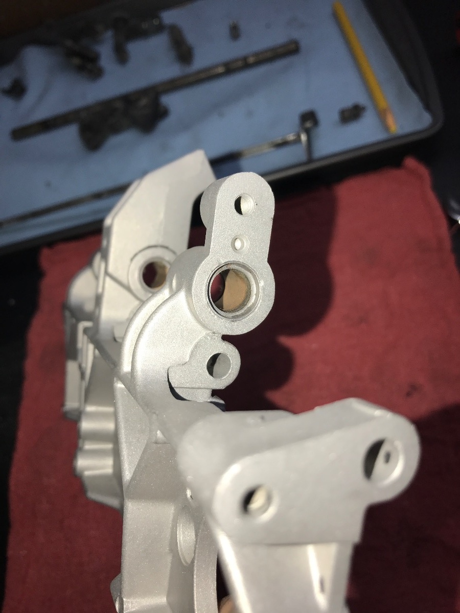

14 May 2017 15:50
Thanks for the info once again guys. I'll tell you what...that black paint is a bear to get off!! I used paint stripper on the mounting plate and one of the carbs then used glass to blast it. It still took some effort!! I saw that there are felt rings inside the mounting plate and one of mine is half gone. I'm not sure if it'll mess me up or not. I feel that it will be fine, but I'll defer to the experts.
