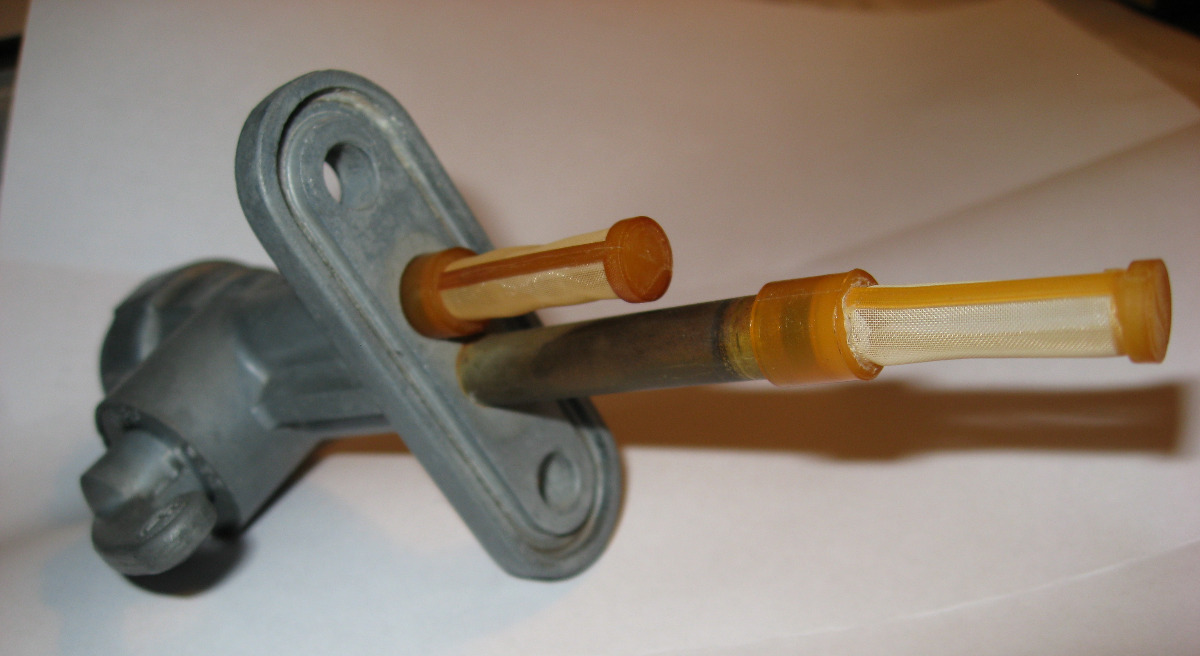

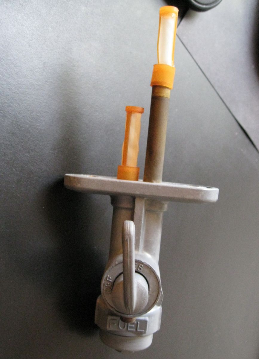

Your petcock looks the same as the one on my 1977 KZ650 (see images below). The parts diagrams show the round style petcock on all the KZ900 models. Maybe someone installed a fuel tank on your bike from a different model KZ. Ed

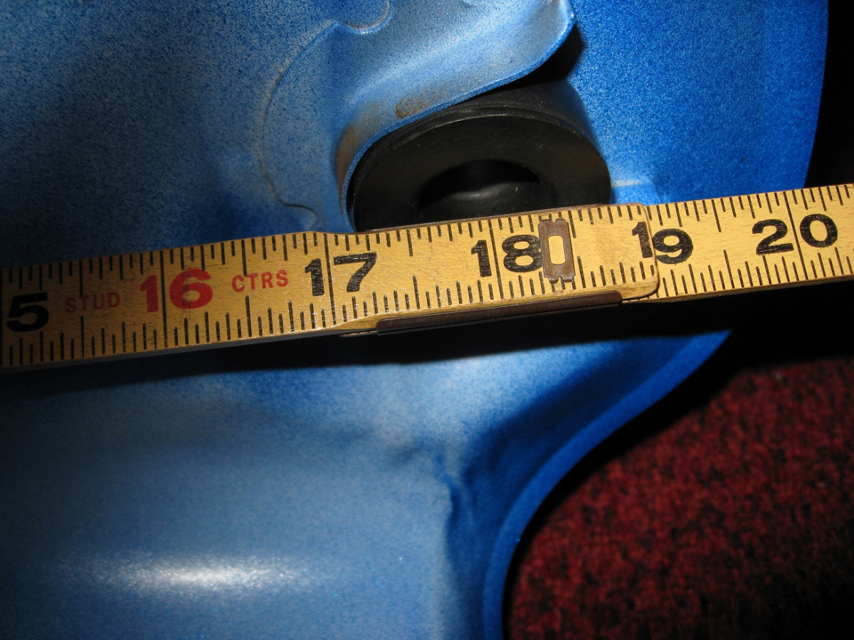

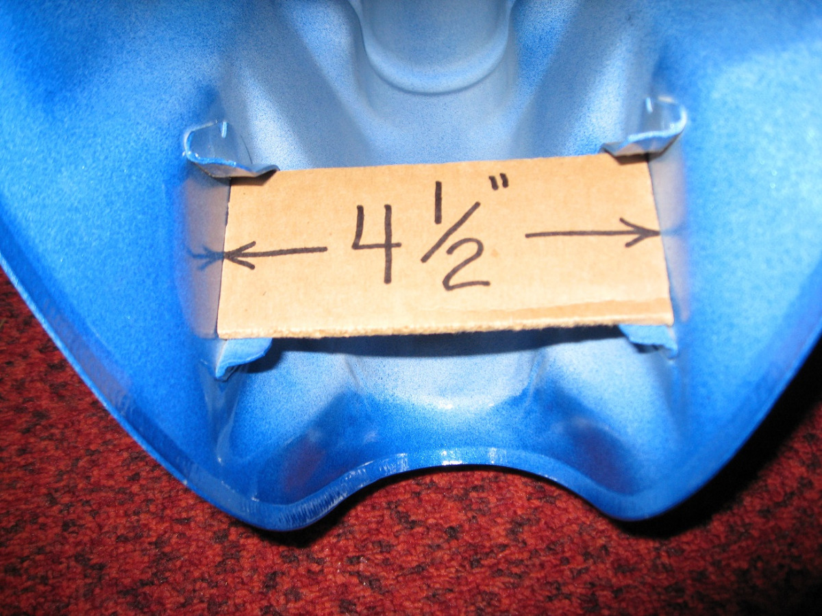

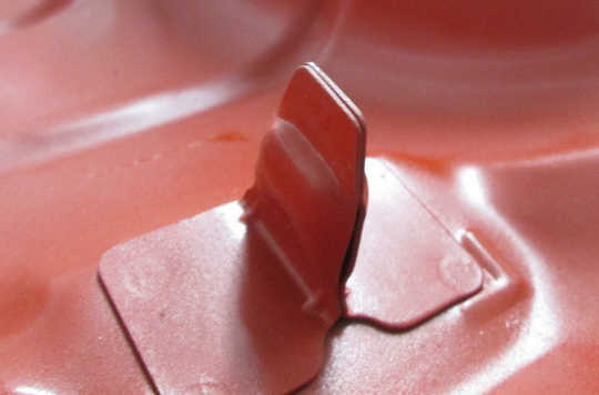

My petcock has a single outlet and my carbs are fed by a single fuel line, so I don't have a tee.
I think the tank shapes are a little different. The images below show the dimensions of the mounts on the bottom of my tank. Mine has a tang at the rear (see orange tank pic below) that engages a rubber piece on the frame and two semi-circular mounts near the front of the tank that engage two rubber pieces near the front of the frame. The distance from the center of the tang to the center of the front rubber pieces is about 18 inches, and the width of the tank at the rubber pieces is about 4.5 inches. Ed
