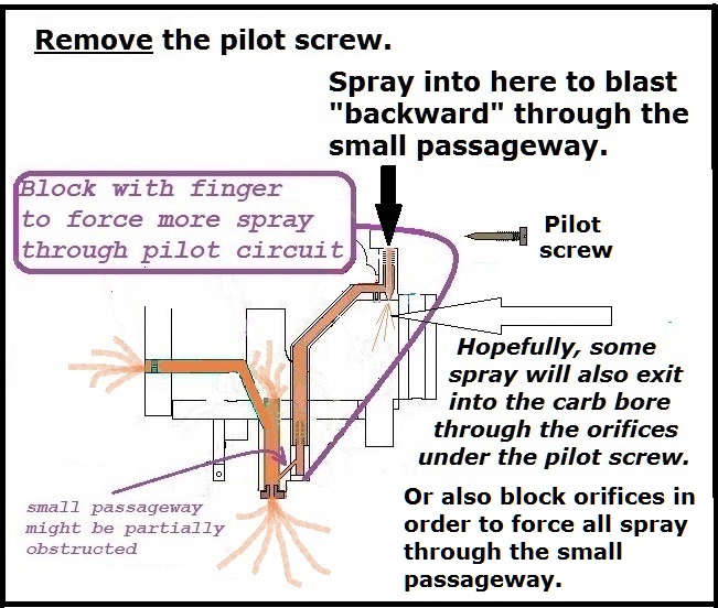

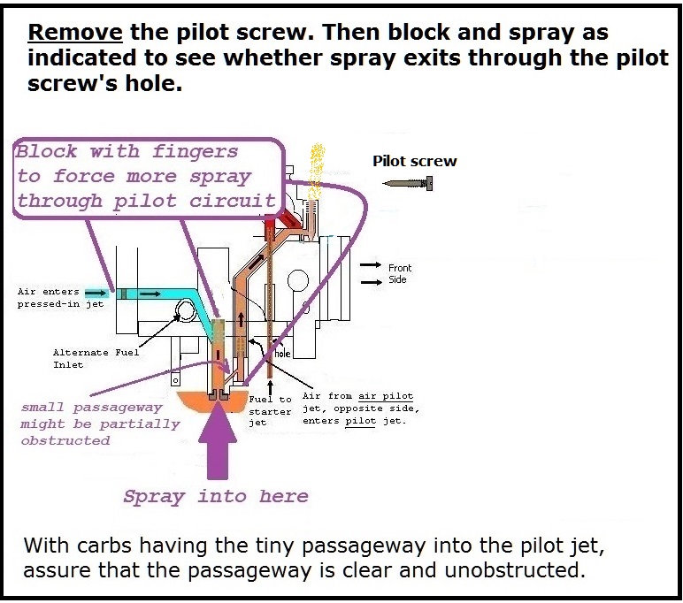

I'm re-cleaning mine now. How do you make sure the passage from the starter tube to the fuel screw is clear? It has some right angle turns so not sure a guitar string will work. I'd rather not have to un-gang and dip them but I will if that is what it takes.

21 Apr 2017 17:04jdvorchak wrote: With the bowl off you will see the passage way where the starter tube, attached to the carb body, goes. Down at the bottom of that is the tiny jet so a guitar string goes right down there. Yes there is a tight turn at the bottom that connects to the interior of the float bowl but the jet is in the vertical part. Now I caution you. You can poke the string down there and you can sometimes feel the clog and twisting the string a little will push through. BUT you have to squirt your cleaner into that hole from both directions as it will sometimes re-clog. So squirt both directions a few times before you call it clean.
No. I know how to clean the fuel bowl. I'm talking about the passage from the bottom of that tube to the pilot screw. In Patton's pic it is the Fuel to Starter Jet that goes up to the pilot screw.

- Posts: 18567
- Thanks: 2103
Last edit: 22 Apr 2017 06:11 by Patton.
The following user(s) said Thank You: GPz550D1, ThatGPzGuy
- ThatGPzGuy
- Posts: 1534
- Thanks: 410
Re: Mikuni BS34 Has Me STUMPED!
23 Apr 2017 18:43
Yep. II have those printed out and am referring to them while I work on my carbs.
