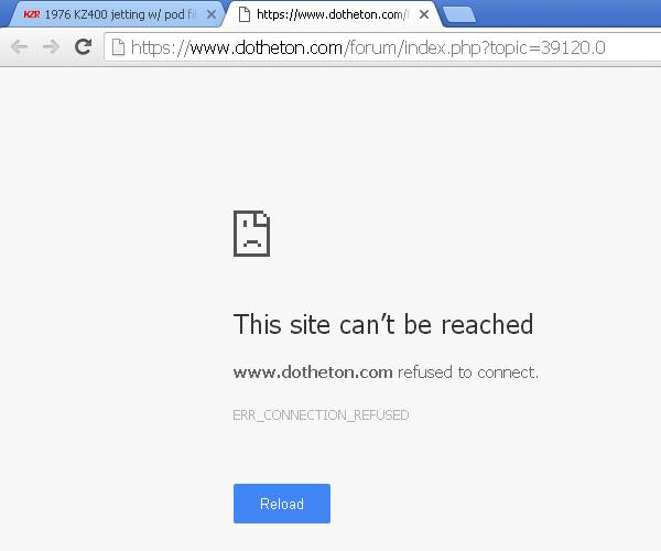

23 Apr 2017 08:20Nebr_Rex wrote: Been there done that.:woohoo:
Check out page 12 in the link on the bottom of my sig..
I get this when I check the link:
