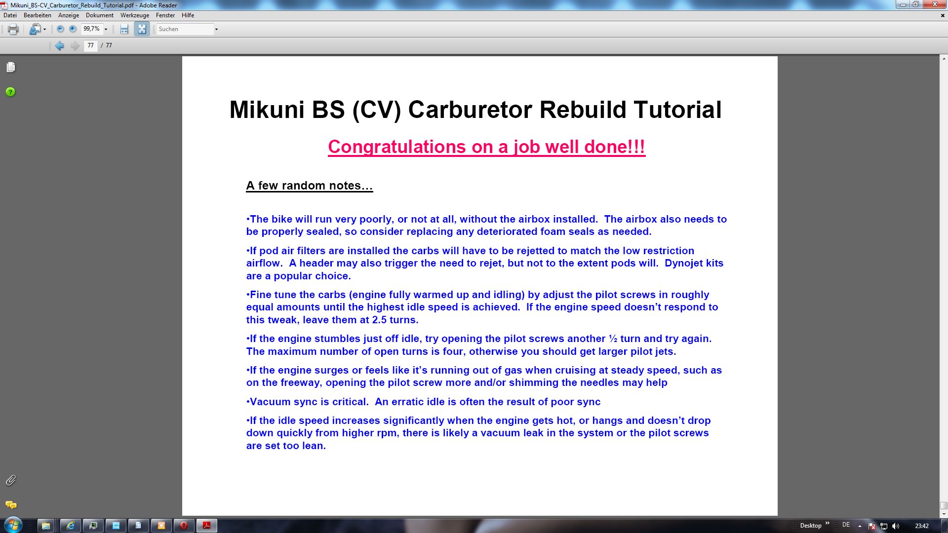

Full service manual, (German only)
manualedereparatie.info/manuale/Kawasaki...dereparatie.info.zip
www.manualedereparatie.info/manuale/Kawa...dereparatie.info.zip

Thank you. This is very useful, even if i think I know how to rebuild carb. I did alot of times.
What drives me crazy is the fact my carbs are spotless. Every passage is clean and squirt carb cleaner.
The boots for the zx900a are not the oring tipe. And they are no bolt type.
They are just all rubber. A clamp hold the boots on the head, another clamp hold the carburetor.
They are new.
I tried the mix screw all the way in. Bike obliviously stalls.
Al the way out: smell rich and seem "sleepy" i dont know the right word.
In both situations no change the hanging idle.
I think the carb have something wrong i cant find.
The engine had this issue since i bought the bike :negletted.
I thought a carb rebuild and new boots will cure it, but no glory.
When engine is hot, if i pull the choke half way the rpm go higher. If i pull the choke full the bike stalls.
I adjusted the idle know with engine very hot at 900rpm. Nothing. If i rev it, still hang to 2000 rpm, then slowly drop to idle.
Wtf

Yes,this sucks but somewhere in your carb system is an air leak.
I have a friend with a Suzuki 800 Intruder with the same problem,i try everything to get
the bike run well at idle,nothing helps. I was totally confused.
At last It turned out that the shaft of the butterfly's ( or Carb body bore ) at this point was totally worn and cause an air leak.
After a we changed the complete carb body with an other used one all got well!
Sync the carbs and choke mechanism on this bike is a real challenge, trust me.
